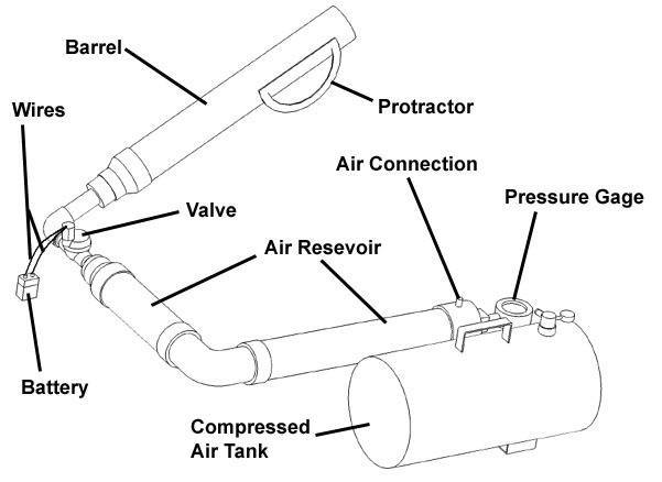

I have built a pneumatic tennis ball lancher (with compressed air). I need to develop theory (i.e. equations and formula) to determine the velocity as the ball leaves the barrel. I have the projectile motion after the ball leaves the barrel down pretty well. I'm having issues acounting for pressure drop among other things.
As seen in the attached picture, there is a PVC resevoir with has compressed air. The valve opens by a current from the battery and the air shoots the ball out. Note I need physics forumlas and not a link to a projectile motion calculator site.

My suggestion is to take the experimental route for this. Measure values of muzzle velocity against pressure and then find the relation between the two so you have a method to predict the muzzle velocity based on the pressure. Ideally you should use something that can directly measure the muzzle velocity, if not you'll need to do calculations to take air resistance into account in the values you do measure (like how far the projectile goes).
However, for fun (cause Diff Eq is fun), here's what I can come up with off the top of my head for the formulas:
Initially you'll have:
[tex]F(t=0)=P_{diff}(x=x_0)*2\pi r^2[/tex] Which is the force is equal to the difference of pressure (the pressure inside the tube minus the pressure outside) times half of the surface area of a sphere.
Now you'll need to take into account the fact that as the ball is ejected from the tube the pressure behind it will decrease and so the force exerted on the ball with change, so in comes (I'm going to leave the subscript diff off of the pressure here for ease of typing, but realize I'm still referring to the differential pressure):

Piratephysicist,
I think you are assuming static pressure all along the barrel. I did a calc. long ago to try and determine muzzle velocity and the tech. I adopted is similar to yours. The results were way off from expected values.
I have not retried my calc. but I feel that there's a prob. in using the (PV = constant) to try and determine instantaneous pressure on the projectile at any point in the barrel. The reason I think is because the gas law eqn. applies for static pressure (like gas compressed in a vessel). At a point in the barrel far away from the valve, I doubt if the pressure can be calc. by substituting V2 = (V1 + b) in the eqn : P1/V1 = P2/V2. Here 'b' is the swept barrel volume and V1 is the reservoir vol. Here P1, V1 and V2 are known. This is what I did and as I said, my results were off.
At a point in the barrel away from the valve, the air is moving very fast. However, because the barrel vol. is pretty small compared to that of the reservoir, the air will not be fully decompressed. It will still be in a state of compression (although lesser than in the reservoir) and it will also be moving. IN SUCH A STATE, HOW DOES ONE CALC. PRESSURE ? If the air is fully decompressed (at 1 atm) and only moving along fast, the pressure exerted is simply the dynamic pr. = 0.5 x (density) x (vel)^2 (and that's pr. on a FLAT surface, not a curved one)
This thing is real tricky, that's for sure .... let me know what you think.

I have given a simple and rough treatment for another situation much like this in another thread. It's nothing but work done during adiabatic expansion. Then we can equate work done to mv^2/2. Perhaps you can have a look at it.

I think the OP had wanted a theoretical model against which he could measure his practical data. Ultimately, he will have to resort to experiments as you have described to know exactly how his machine behaves, but without a theoretical baseline to compare against, how would one know how efficient a machine is, or to what limits he should be able to push it to?

Great going!
To clear up some minor points.
V1 is simply the volume of the compression chamber. Nothing to do with where the ball sits. So, why have you given it as (pi*r^3)/3. A factor of 4 is missing, if it's spherical.
V2 should be taken as the volume of the compression chamber plus everything including the barrel upto the point where the ball is ejected, or upto the point where in practice the gas is doing no more work on the ball.
If the height difference between the mouth of the barrel and where the ball sits is h, then work done on the ball is mgh+mv^2/2. Here, the ball is being ejected at some angle to the horizontal.
I suggest for the first approximation, you consider a horizontal barrel. Then mgh=0. We will put in friction later.
