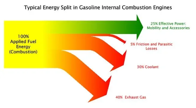

I'm new here and have spent 2 years moping about the following image:
http://home.europa.com/~garry/energy split.JPG
Has this image been discussed at your forum?
Does this image take into account the 2nd law of thermodynamics?
Have I been chasing a wild goose?
I do believe this image has been used before here (or something very similar to it).
Yes this definitely takes the second law into account.
How can we say you've been on a wild goose chase if you haven't even said what you were looking for?
So it's not a waste of time trying to extract the other 60-70% of the energy?
I guess that was the question I was trying to ask.

A lot of work has been done, especially in the area of extracting energy from the 40% contained in the exhaust. However, like the second law implies, you will NEVER be able to convert all of that energy into useful work.
Yes it is a "waste" of time.
Yes. I understand that. Shouldn't the graph then have an extra arrow labeled "energy which cannot be extracted due to the 2nd law..."?
I'm just trying to get someone to validate their numbers.
I don't know. Obviously the person's picture was of a more general nature, saying where the energy goes rather than what is actually usable.
stewartcs said:
Well, as a starting point it did.
I ended up here: http://mb-soft.com/public2/engine.html
The author described in detail why the graph looks the way it does.
He ended the paper with some research he had performed where he was able to take a 3.5hp engine, modify it somehow, and generate ~45 hp, at which point it blew up.
He did in the paper provide one number I was looking for; the temperature of combustion: 4000'F
Which from the http://hyperphysics.phy-astr.gsu.edu/hbase/thermo/carnot.html#c1" provided by your link yields a theoretical efficiency of 88% in a perfect carnot engine.
So I guess I've answered my own question. It is not a waste of time.
Though I suspected this all along as I didn't think those Bavarian's would waste their time on something they hadn't researched first.

That being said, increasing efficiency of an engine by trying to effectively utilize some of its waste heat is a big deal for a lot of auto manufacturers. I seem to remember reading that Mercedes and BMW are researching next-gen hybrid systems that use a small steam turbine powered from steam boiled from the exhaust gases to help the combustion engine along.
BMW's "trubosteamer" system nets a 15% increase in efficiency essentially for "free" (from energy that would otherwise be lost):
http://www.autoblog.com/2005/12/09/bmw-turbosteamer-gets-hot-and-goes/
How to extract heat energy and turn it into useful mechanical work is the biggest hurdle, especially in the case of energy lost through the radiator because the temperature difference between coolant and ambient is relatively small (~100C).

I think it's definitely a waste of time to try and utilize the remaining 60% to 70% lost in the heat engine depicted in the OP's link. That would indicate a heat engine that is 85% to 95% efficient. I don't think that is plausible, which is why I said it was a waste of time.
However, it's not a waste of time to try and increase the efficiency of a heat engine to some degree by utilizing the exhaust gases.
There is some of that in each of the listed losses. I don't think exact quantity that can never be extracted is something you can calculate. It depends on how far you are willing to go to extract it (which is the whole reason it is such a complicated issue to deal with).
[edit] Ugh, I really shouldn't have forgotten this by now, but I think all of that energy shown as losses is "unavailable to do work", but only for that particular cycle. If you modify the cycle or add another cycle on to it, you change the entropy.
