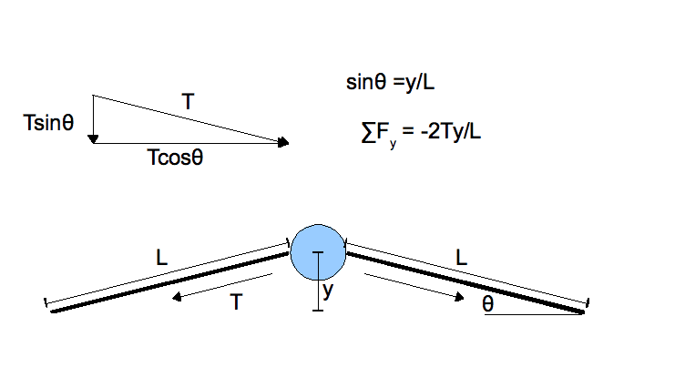

A ball of mass m is connected to two rubber bands of length, L, each under tension T, as in Figure P12.49. The ball is displaced by a small distance y perpendicular to the length of the rubber bands.
(a) Assuming that the tension does not change, show that the restoring force is -2yT/L .
(b) Assuming that the tension does not change, show that the system exhibits simple harmonic motion with an angular frequency .
I have no idea how to solve this. I think it has something to do with F=ma, but I don't know exactly what.
Help?

Ok, here's how I'm envisioning the problem:
http://img89.imageshack.us/img89/2307/tensionde4.th.png
This picture is attached as well.
Part a is fairly simple, if you look at the vector diagram, you can see that the downward component of the tension force from EACH rubber band is given by -Tsin(theta), where sin(theta) = y/L (which should be clear from the geometry in the figure.
Then, in the vertical direction, Newton's second law becomes:
may = -2Ty/L
Shooting star is using calculus to write this as:
[tex] m \frac{d^2 y}{dt^2} = -2T\frac{y}{L} [/tex]
Where the symbol [tex] \frac{d^2}{dt^2} [/tex] should be taken to be one whole symbol that is being applied to y, and it means "take the second dervative of y with respect to time." If you don't know what that means, don't worry about it. This is the differential equation of a simple harmonic oscillator, but I don't think your teacher intended for you to use differential equations to solve for it. So, given that you have a RESTORING FORCE i.e. our equation is of the general form:
may = -ky
where k is some constant, it seems pretty clear that we'll get oscillation. What rules has your teacher taught you about deducing the frequency of oscillation (omega) using this type of equation as a starting point?

In an SHM, the eqn is ma = -kx. So, if you can reduce the eqn to this form, we immediately know that it must be SHM. The omega = sqrt(k/m).
We have already shown that the eqn is ma = -(2T/L)y, where y is the displacement. Then omega should be sqrt(m/(2T/L) = sqrt(2mL/T). Note that T has been given as a const.
A typo again! The omega should be sqrt(k/m) = sqrt(2T/(Lm)). Sorry for that.
