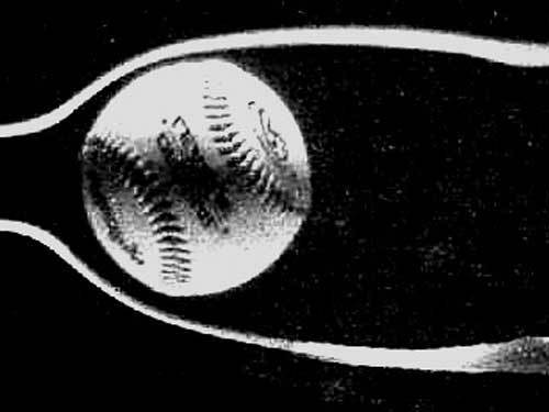

I have a few questions that have to do with a viscosity on the surface of an object, the boundary layer and the boundary layer separating from the surface of a baseball!
1) my first question is if we had a stationary object let's say a baseball on a table would the baseball have a boundary layer? Or would the baseball have to be thrown for it to have a boundary layer?
2) My second question has to do with the boundary layer separating from the surface of a base ball as seen in the diagrams below (the ball is not spinning in both diagrams)

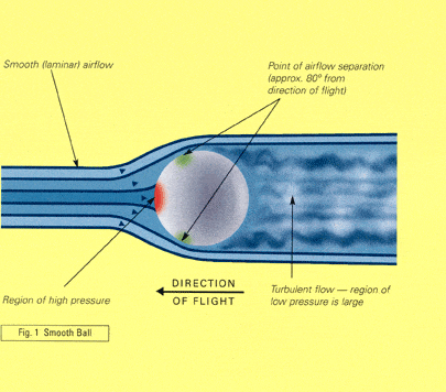

Here is a more detailed diagram
Now I read that a sphere like a baseball is a poor aerodynamic shape and if it is not spinning the boundary layer will separate similar to the figure above creating a large turbulent wake of low pressure at the back while the front has high pressure so the front to back pressure difference creates a backward force on the ball ie drag.
a) i was just curious could this pressure difference on the front and back of the ball be another application of the Bernoulli principle?
b) there was something in the explanation of the diagram above (figure2) that I just didn’t understand first of all here is how the diagram was explained:
As smooth air flows past a ball, it experiences a uniform increase in static pressure in front of the ball, a decrease in pressure along the sides, and an increase in pressure towards the back. As the air pressure increases toward the back, the air molecules lose their ability to follow the curvature of the ball (as they try to fight the increasing pressure).
The cause of this separation happens because As the flow moves downstream from the 90° or 270° position, it encounters an increasing pressure. Whenever a flow encounters increasing pressure, we say that it experiences an adverse pressure gradient. The change in pressure is called adverse because it causes the airflow to slow down and lose momentum. As the pressure continues to increase, the flow continues to slow down until it reaches a speed of zero. It is at this point that the air no longer has any forward momentum, so it separates from the surface. separated flow creates a region of low pressure in the wake!
i) fist of all why is there a “decrease in pressure along the sides” of the ball?
ii) the above explanation also says As the flow moves downstream from the 90° or 270° position, it encounters an increasing pressure…………As the pressure continues to increase, the flow continues to slow down until it reaches a speed of zero. It is at this point that the air no longer has any forward momentum, so it separates from the surface
Where is this Increase in Pressure along the 90° or 270° Coming From? Is it because the air is trying to fallow the curved surface but cannot because the shape of the ball is unaero dynamic?

The boundary layer only makes sense in the context of motion of the fluid with respect to and object or surface, or with respect to motion of an object in a fluid. The first situation would be like air in a wind tunnel flowing past a model aircraft, or fluid in a pipe, and the second situation is that when a ball or aircraft travels through the air. The fluid-object interaction and fluid dynamics is similar.
Also, not only is a spherical shape relatively poor aerodynamically, from the standpoint of drag, by cylinidrical geometries are also poor aerodynamically, and vortex shedding is also an issue, particularly in heat exchanges that employ parallel tubes in cross flows of high Reynolds number.

i) fist of all why is there a “decrease in pressure along the sides” of the ball? [...] Where is this Increase in Pressure along the 90° or 270° Coming From?
In my opinion, this question is not exactly correctly posed. Why is the speed of light the upper limit? Why is gravitational force inversely proportional to square of distance? Why is... Because they have just been assumed/observed to be, and theories built upon such assumptions have shown prediction capability.
So with the fluid flow, based on observations, there are equations of rising complexity which have been formed to model it. The simplest of them, potential flow equation (for which Bernoulli holds too), has an analytical solution for the sphere which will show this 90°/270° peek of underpressure. In particular, the realistic, viscous flow about a sphere which you are pondering about, will start by reproducing the potential flow solution up to some angle, and then veer off due to viscous effects. But, the pressure will still grow to some point, then start reducing, and at some point the flow is going to go ugly, "boundary layer separating".
That's just how the flow is, no why's :) The important bit is that people have been able to come up with some generalizations (equations) based on observing such facts.
Now believe me I am far far far from an expert in physics but these two explanations regarding why the air separates from the surface of the ball seem to be totally different!
They are not really different, just the second one is throwing into the mix another observed characteristic of viscous fluid flows -- turbulence. Don't think of turbulence as that which throws you about in an airplane, a pack of rough air or something. In this context, the turbulence is a particular flow feature, which has been observed to happen when the object of given size reaches some speed. This is why the second explanation is having the "fast enough" part.
However, turbulence is not responsible for the boundary layer separation. It will happen whether there is turbulence or not. The rise of turbulence only influences how and when it happens. It goes like this: flow is very slow, separation is very well past the 90°/270° point; it starts to take up speed, separation starts moving forward, and it comes in front of 90°/270° point; sometimes in the meantime (depending on the size of the object), the turbulence may appear, which suddenly pushes the separation point again to the back.
What's this stuff about turbulence then? Well, the equations which model viscous fluid flow, Navier-Stokes, happen to be non-linear. This means they can have many solutions, but mysteriously the nature chooses only some of them -- and there are experiments where people "force" the nature to provide one or the other solution for the one same flow setup. And then a lot of talk how to compute solutions to Navier-Stokes equations such that they correspond to those in nature...

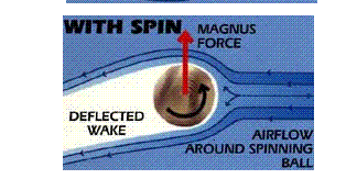

1) In thee case of a baseball thrown with no spin (like in the first diagram below) when the airflow reaches about the half way point around the ball the bend becomes too tight for the air flow to follow the curved surface this creates a lot of high pressure at the top and bottom of the ball that the viscosity of the air can’t support so the boundary layer separates. Did I get this right?

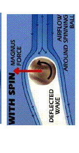

2)On the other hand if we were throwing the baseball with a lot of spin (Like in the diagram below) this would change the pressure around the ball. On the top side of the ball we have the ball’s surface spinning in the same direction as the air flow this would speed up the air flow on that side and decrease the pressure so this would allow the ball to pull the boundary layer further around the top side of the ball before separating. On the bottom side of the ball we have the ball’s surface spinning in the opposite direction of the airflow creating a lot of friction and slowing down the air flow, this would increase the pressure on the bottom side of the ball and the boundary layer to separate earlier. This deflects the wake downward and according to Newton's 3rd law the wake being deflected downward is the action and the reaction is a lifting force upward. And there is also a lifting upward due to the pressure differences acording to bernoulli's principle So did I get this right?
thank you very much and i hope to hear from you soon
yes you did. that is why a spinning ball swerves in the air.

Ok I understand that a spinning ball creates lift. And that’s what makes a baseball curve But I am kind of curious how to increase the lifting force and create more lift (obviously just add more spin) but I also read some information on Curve Balls that if the ball is thrown faster this will create a little bit more lift for the same amount of spin causing it to curve better.

The lift simply has to do with the differential pressure across the ball (between top and bottom). The rotation compresses air under the ball. The compression comes from the forward speed, so increasing the speed compresses the air just a little more. Rotating faster maintain slightly more compressed air under the ball - that is before the air molecules diffuse/flow away from the ball into the lower pressure air sorrounding it.
At the surface of the ball, the air has zero velocity, which is the reason a boundary layer develops. The motion of the ball (or any object) compresses the air with which it interacts, and the air then moves around the object while pressure and velocity gradients develop.
The objective with lift is to get the air underneath to compress while the air on top is either not compressed or slightly reduced in pressure. The differential pressure gives the lift by creating a net vertical upward force.
In the example given the rotation moves the air quickly over the top so that the compression is less, while on the bottom the air is slightly more compressed. The downward wake comes from the air being pulled down at the surface of the ball, and that deflection (acceleration) also adds to the lift.
I took a curve ball curving to the left for an example, would more lift be created because the faster the ball is thrown the faster the air flows over the left side of the ball which is spinning in the same direction as the air flow, this decreases the pressure on that side and allows the ball to pull the boundary layer further around the left. on the other hand on the right side of the ball the ball's surface would still be spinning in the opposite direction creating high pressure causing the boundary layer to separate earlier. So the wake would be deflected a little more to the right. ie more air is deflected faster to the right so we get a greater lifting force to the left based on a variation of Newton’s second law Force=mass x acceleration.
Are you now talking about a ball spin around a rotational axis parallel to the velocity. That would be different than the one shown in the illustration.

Drag increases with forward speed, and the compression of the air would increase with the speed, which would improve the curve of the ball.
Omegared said:
something else that i found a bit confusing was that the site above clearly says that an increase in forward speed of the ball can make a baseball curve better for the same amount of spin in the 60ft between batter and pitcher. And yet other sites seem to imply that this is not possible because even though the lifting forces are increased by throwing the ball faster it also gives the forces less time to act so the ball actually has less of a curve.
Both statements are correct. The ball has mass, so it takes time for the lift force to change its path sideways. Higher initial velocity means higher lift, but less time to the target; and vice versa. For a given ball, amount of spin, and distance to the target, there exists one optimal initial velocity that will give the most curvature to the path. Don't even think of asking how to compute that velocity :)
In practice, given that the lift force grows with the square of velocity, and time to the target drops only linearly, it may be that in the given baseball scenario no one can actually throw so fast to go over the optimal initial velocity, hence the "throw as fast as possible" advice.
