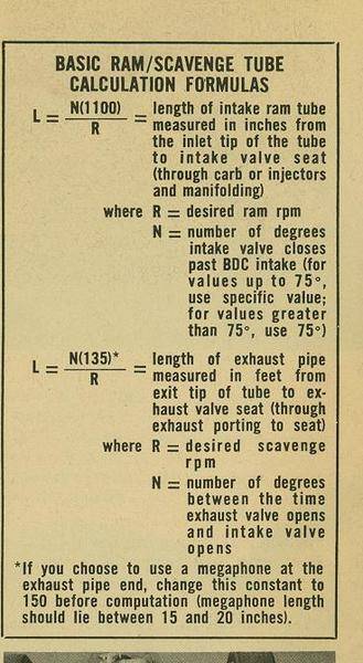

The short answer is yes..exhaust should be tuned to RPM range for max performance. Too little back pressure kills off low end torque. Too much BP makes the engine labor too hard and kills off horsepower. I just went thru this with my diesel pick up truck..tried to take the cheap way out by running 3 inch pipe from turbo to the axle ,,i could feel the engine really laboring when going up hill..i swiched to 4 inch turbo back and things really came alive...a friend had gone to insane 6 inch turbo to axle and said his bottom end suffered but not high end performance. emperical data...yes the dyno numbers bear this out so some BP is good

Fantastic, thank you very much, I will definitely start fiddling with diameters and tuned length. So glad finally found a forum that helps me, Ranger Mike, You da man.
