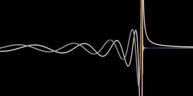

and the correct answer is...
For the Green's function of the Feynman propagator:
[tex]
D^{\cal F}(E,p)\ =\ \frac{-1}{E^2-p^2-m^2+i\epsilon}\
[/tex]We get in position space: (congratulations to the starter of this thread)
[tex] D^{\cal F}(t,r)\ =\ \frac{m}{8\pi s}\ H^{(1)}_1(ms)[/tex]where [itex]s^2=t^2-r^2[/itex] and [itex]H^{(1)}_1(z)[/itex] is the complex Hankel function of the first kind
and first order. It is the Bessel equivalent of [itex]\exp(iz)=\cos(z)+i\sin(z)[/itex]
[itex]H^{(1)}_1(z)=J_1(z)+iY_1(z)[/itex]
Where J and Y are the Bessel J and bessel Y functions. As one could expect:
The complex conjungate of the propagator looks like a positive energy
exponential for (t>0) and like a negative energy exponential for (T<0).The trick was to do a Fast Fourier Transform on the function minus the function
for the massless particle:
[tex]
\frac{\pi}{(2\pi)^3}\ \frac{1}{|t|}\ \int_{-\infty}^\infty dp\ \bigg[\ e^{ -i\sqrt{p^2+m^2}|t|}\ ~~-~~e^{-i |p| |t|}\ \bigg]\ e^{-irp}
[/tex]
The argument now goes to zero when p increases and we can calculate the
massless case: [tex] D^{\cal F}(t,r)\ =\ \frac{1}{4\pi}\ \delta(s^2)\ \ +\frac{i}{8\pi^3}\ \frac{1}{s^2}[/tex]
The result of the mentioned FFT compared with the mathematical result
can be seen in the image.
Yellow: Real value of the FFT
White: Imaginary value of the FFT
Blue: Real value calculated
Red: Imaginary value calculatedRegards, Hans
