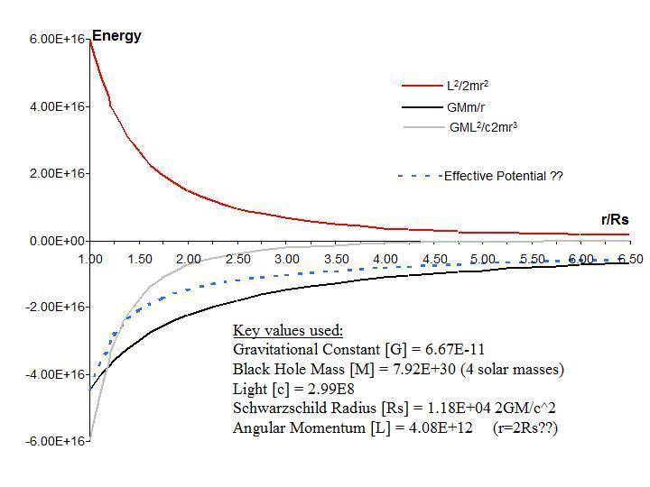

I am trying to draw one of those nice plots of effective potential [Vr] against radius [r], which suggest the position of stable and quasi-stable orbits. Have no trouble getting the classical curve showing a minimum coinciding with a radius corresponding to a given angular momentum [L], but having trouble getting the equivalent min/max curve associated with general relativity. By way of reference, I was initially looking at the following Wikipedia page:
http://en.wikipedia.org/wiki/Kepler_problem_in_general_relativity
This page has two sub-titles that are relevant:
`Relation to classical mechanics and precession of elliptical orbits`
`Circular orbits and their stability`
Under the first sub-title, the following equation for the effective potential is listed as:
[tex]Vr = -\frac{GMm}{r} + \frac{L^2}{2mr^2} - \frac{GML^2}{c^2mr^3} [/tex]
The first term relates to gravitational potential energy, the second relates to kinetic energy of rotation, while the third is described as "an attractive energy unique to general relativity". It is stated that the 3 terms, containing different powers of radius [r], combine to give a curve with a minimum corresponding to a stable orbit and a maximum that relates to a quasi-knife-edge orbit. However, when I put the figures into a spreadsheet I don’t get this min/max curve.

If the assumptions made are correct, it would suggest that a larger gravitational force/curvature is required to counter the `centrifugal` force. This factor would appear to only range between [1:2]. Equally, this expression could be solved without the use of the quadratic approach normally employed, e.g.
[tex] v^2 = \frac{Rs*c^2}{(2r-Rs)} [/tex]
Therefore, I not sure any of the assumptions made are correct as I have not seen this approach presented in any standard text. Therefore, I would appreciate any help that could be given to clarify the situation.

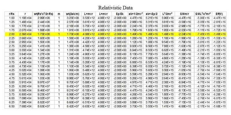

I have attempted to upload a .jpg file showing the graph obtained when plugging some example black hole values into the wikipedia equation. Hoping somebody might be able to tell me why the the effective potential, i.e. the sum of the other 3 curves does not produce the min/max curve expected.

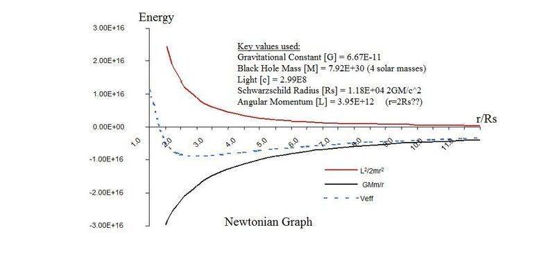

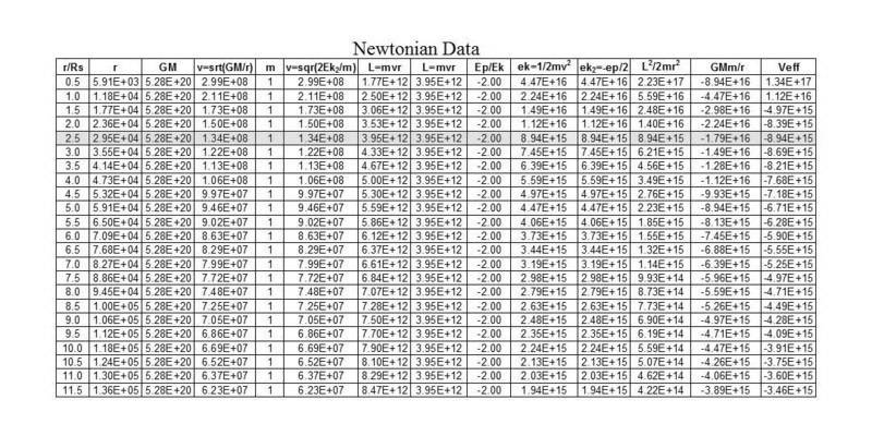

Kev: Appreciate the detailed feedback; it is indeed helpful to have somebody check whether I had made an obvious mistake, although I am sure it is there somewhere. I was not sure from your last post, whether you had tried plotting the effective potential curve? Just by way of reference, I have attached 3 .jpg files to this first post, which might be useful as a reference with respect to the discussion in the next post, which tries to follow on from some of the points you have raised.
The first two diagrams relate to effective potential of an example black hole based on Newtonian assumptions, i.e. without the additional gravity terms. This plot produces a minimum that coincides with the value of angular momentum [L] being held constant. As such, the minimum [Veff] corresponds to a classical radius of a stable orbit with this angular momentum at r/Rs=2.5. Another point worth noting is that the kinetic energy associated with the orbital velocity is always half the potential energy of gravitation. This point is raised because I was wondering whether this ratio holds true in the relativistic equivalent?
The last diagram is the data for the relativistic plot submitted in an earlier post. It is essentially the same example black hole, but includes the additional relativistic terms, as per the equation sourced by Wikipedia. However, rather than the relativistic term, driven by [tex]1/r^3[/tex], causing a min/max peak corresponding to stable and quasi-stable orbits, the effective potential appears simply to roll off, implying no stable orbit, which would appear to be obviously wrong.

I notice you have 2 columns in your spreadsheet both headed as L = mvr, one of which is constant and the other varies. Which L are using in your plots? Constant or variable L?
P.S. I am inclined to prefer the foumilab equations because they need to get the equations right to get the applet to "work". Also bear in mind that there is potential confusion due to Wikipedia using V to represent velocity while fourmilab use V to represent effective potential energy. With a bit of luck a real expert will jump in and help us both out here :P When I get time I will I will have a look at the code for the applet. The answer is in there!
The plots are based on the constant value. In the classical case, the minimum value coincides with the corresponding value of radius [r/Rs=2.5]. I was trying to post another reply, but the preview keeps crashing on me!
The problem I have with the Fourmilab equation is that doesn't seem to be consistent with the classical derivation of effective potential I found. This is what I was trying to post. The reason for posting this information was simply that an 'expert` might be able to resolve the issue by looking at the data.

[tex] \frac{mc^2}{2}\left(1-\frac{Rs}{r}\right)^2 \left(\frac{dt}{d\tau}\right)^2 = \left(1-\frac{Rs}{r}\right) \left(\frac{L^2}{2mr^2} + \frac{mc^2}{2} \right) [/tex]
So the first question is whether the expression on the right aligns to the effective potential, as the form appears to correspond to the Fourmilab format. However, if we expand this expression, we get:
[tex]\frac{L^2}{2mr^2}+\frac{mc^2}{2}-\frac{Rs}{r}*\frac{L^2}{2mr^2}-\frac{Rs}{r}*\frac{mc^2}{2}[/tex]
Substituting for [tex]Rs=2GM/c^2[/tex]:
[tex]\frac{L^2}{2mr^2}+\frac{mc^2}{2}-\frac{GML^2}{c^2mr^3}-\frac{GMm}{r}
[/tex]
Now the similarity to the Wikipedia equation re-emerges, albeit with the [tex]mc^2/2[/tex] addition, which in the Wikipedia derivation is moved to the other side of the equation. However, the classical derivation of effective potential suggests:
[tex]Et = 1/2m\left(\frac{dr}{dt}^2\right)-Veff [/tex]
Of course, in the case under consider, i.e. a circular orbit, the term [tex]dr/d\tau=0[/tex] and therefore we get the situation where the total energy [Et] must equal the effective potential, which in turn equals the sum of the kinetic energy associated with the orbital velocity plus the potential energy of gravitation. If this is the case, it seems to support the fact that [tex]mc^2/2[/tex] is not a component of the effective potential, but rather a component of the total energy, as implied by the Wikipedia derivation. However, the problem that I am raising is that neither seems to produce the expected max/min curve.
One of the advantages of using a constant value of angular momentum [L] for all values of radius [r] is that you do not have to know the explicit value of the orbital velocity. The implication is that the values within a spreadsheet will only tie-up when the angular momentum is matched against the appropriate radius [r], i.e. this corresponds to the minimum dip in the curve, at least, in the case of the classical solution shown in an earlier posting. Another point worth raising is that a classical orbit has a specific ratio between the kinetic and potential energy, i.e. [Ek=-Ep/2]. In my example, the black hole mass [M] was set to 4 solar masses and a value of angular momentum [L=4.08E12] was selected to be in the right range for a radius spread between 1-10Rs. For the values indicated, the kinetic energy [Ek=-Ep/2] at a radius of 2Rs.
It is accepted that there must be some flaw in this logic, but it is still unclear why the relativistic effective potential does not produce the max/min curve. Should any member of the forum know the answer, it would be much appreciated.

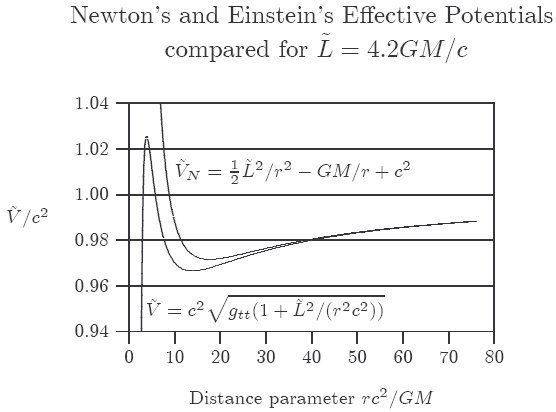

I haven't gone through all your derivations, but I use a variant of what is found in MTW, with c and G reinstated:
[tex]
V_{eff} = c^2\sqrt{(1-2GM/r)(1+L^2/(r^2c^2))}
[/tex]
where V and L are per unit mass.
I get the curves as attached, normalized and with g_tt = 1-2GM/r. The Newtonian curve has c^2 added to put it at comparable level to the relativistic one. Note that if you choose L < 3.4642GM/c, you won't get a lower turning point in the relativistic case.
Hope it helps.
Thanks very much. I will take a closer look and let you know how I get on.
Jorrie is right that you will not get the min max curve if L is less than about 3.46 as can be seen by using the fourmilab applet. I think that may be the main problem you are having. Did you get the private message I sent?
