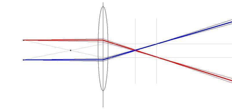

On the second, my response is to look at the Dopfer experiment. The detector at the focal point has some finite size - it's not a point. Yet the interference pattern generated is close to perfect.
What does the interference pattern have to do with it, though? You'd predict an interference pattern in the double-slit experiment even if you explicitly assume the slits have a finite width. I thought we were talking about the issue of whether 100% of the photons that were detected on the bottom apparatus would also have corresponding hits in the focal plane of the large lens.
peter0302 said:
Which indicates to me that there is a small amount of wiggle-room here in terms of being exactly on the focal point versus being a millimeter or fraction thereof away from it.
Well, by making the detector behind the large lens in the upper apparatus wider than a point, you open up the possibility that even though there'd be interference in the subset of photons in the lower apparatus whose twins went to a particular position in the upper detector's range, the total pattern of photons in the lower apparatus wouldn't show interference because the sum of all these subsets would be a non-interference pattern. In this way complementarity could be preserved without opening up the possibility that the total pattern at the lower apparatus would vary depending on what happened at the upper apparatus. I thought your argument critically depended on the idea that all the photons in the upper apparatus would be detected at a single position, so there'd be no way to mark out subsets of hits at the lower detector corresponding to distinguishable subsets of hits at the upper detector, and thus no way to have the total pattern of photons at the lower detector show non-interference without violating complementarity.
Yes, the interference pattern in the bottom half reflects the superposition of many interference patterns of subsets of photons. But as we see in Dopfer, if those photons are detected only a short distance from the focal plane, those interference patterns will only be slightly out of sync with one another, resulting in the near-perfect, but not totally-perfect, pattern we see when D1 is moved slightly away from the focal plane, and then we see the pattern continue to morph into a gaussian pattern as D1 is placed further away.
That is the only explanation of how Dopfer gets an interference pattern by placing the detector D1 - which is wider than a point - and keeping it fixed there. Yes, if D1 were _very_ wide, the pattern of photons in the lower half would be totally Gaussian, but like I said, there must be a margin of error for Dopfer's experiment to have worked at all, and I think the key to understanding it is to look at how the pattern slowly morphs as D1 is moved - otherwise, if what you're saying is right, we'd expect either a perfect interference pattern when D1 is at the focal point, or none at all as soon as D1 is moved a wavelength away.
My hypothesis is that the photons that are slighly off from the focal point will make an interference pattern that is slightly out of phase with the "central" one. Indeed, the wider the detector D1 is, the more of a problem this will be.
Here's a picture of what I'm talking about. At the focal plane, the perfectly collimated beams pass perfectly through the focal plane. Photons that are slightly astray still come very close to the focal point. As long as all photons are detected there the interference pattern should resemble that of Dopfer's.
