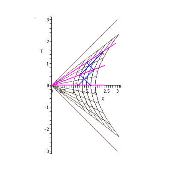

Attached is a sketch (to arbitary accuracy) of how I imagine geodesics can interpreted as straight lines. The sketch on the left is the viewpoint of an observer that is stationary with respect to the massive body and the one on the right is the viewpoint of an observer in the free falling elevator. Does anyone think this is a reasonable interpretation? Have I gone too far with the non locality the diagram suggests?

Ok, so suppose we have a photon that is emitted and absorped between A and B in this field. We also have an observer, who is also in in this field. How exactly does he observe a deflection? How?
Only observers outside your field would observe a "deflection", but this "deflection" is not due to to the field but due to the fact that the observer is not in the field.

Wouldn't a world line passing between (such that the distance to either is equal at any time) two equally massive bodies constitute a "flat space"?
Regards,
Bill

Ok, so suppose we have a photon that is emitted and absorped between A and B in this field. We have an observer, who is also in in this field observer a deflection? How?
Please restate. Your sentance We have an observer, who is also in in this field observer a deflection? How? is meaningless to me.
Only observers outside your field would observer a "deflection", but this "deflection" is not due to to the field but due to the fact that the observer is not in the field.
Huh? What do you mean by "observer is not in the field"? By definition the observer is in the field. That's precisely how one interprets the physical meaning of spacetime coordinates. Let mf give you an example: consider an infinitely large plane of unifrom mass density. This will generate a uniform graviational field. The field is uniform for observers who are at rest with respect to the source, e.g. standing on the plane.
If you'd like me to respond your questions then please respond to mine so that I may better answer yours. Thanks.
