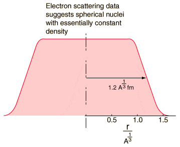

"Various types of scattering experiments suggest that nuclei are roughly spherical and appear to have essentially the same density. The data are summarized in the expression called the Fermi model:
http://hyperphysics.phy-astr.gsu.edu/hbase/nuclear/imgnuc/nrad1.gif
They are saying the radius of the proton is 1.2 fm which doesn't agree with the wiki article.

Look at that picture :
Nuclear matter is not like a hard sphere with a well-defined radius. You need a convention, such as the root-mean-square (RMS) of the distribution, which happens to be convenient because of its relation with the form factors (FF). The FF basically are what you observe directly, they parameterize your cross-section. Under a few simple and reasonable hypothesis, the shape of the FFs will be related to the RMS of the corresponding charge distribution.
0.87 fm would come from the nucleon FF measurements. It definitely tells you about them directly.
2*0.6 fm would come from an approximate fit to the radius as a function of A. You certainly are courageous to take it as such, plug in A=1, and claim a disagreement with the previous number. First hypothesis : the nucleon is the same in a nucleus and in a free state. This is daring. Second (most important here) : the fit does good near the specific low A region, even down to A=1. I would like to see that :smile:
