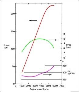

The attached pdf of the BSFC (brake specific fuel consumption) performance of a 2.7 liter engine shows that the wide-open-throttle torque (minimum intake manifold vacuum) is nearly the same at 2000 and at 5000 RPM. The maximum is at about 3900 RPM. The drop off at low RPM is due in part to the cooling of the compression-heated air-fuel mixture by convection to the combustion chamber walls.

ifin you are charting fuel consupmtion for torque, you should chart HP too...it takes a lot of fuel to make HP..BSFC is the " new " trick of the day but is not real world at WOT since 99 percent of all door slammers never use it.. note the chart for a Jaguar V12 HE, the ‘HE’ indicating the use of high swirl heads.
The red line shows power – all the way to about 220kW in this graph. The green line shows torque (although here it is expressed as Brake Mean Effective Pressure). And then we have SFC, shown by the purple line. As can be seen, the SFC curve doesn’t initially appear as you might have imagined it would.
At idle it’s about 280 g/kWh, then as revs rise, it drops to be at its lowest at about 2500 rpm (at say 270 g/kWh). From there it rises steeply to reach 350 g/kWh at 6000 rpm.
Now why should the SFC be lowest at middle RPM? Or, to put this another way, what causes an increase in fuel used per kW at both low and high revs?
At low revs, SFC suffers because there’s increased time for the heat of combustion to escape through the walls of the cylinders and so not do useful work. At higher engine speeds, the frictional loses of the engine rise alarmingly (especially in this case with 12 cylinders!) and so the energy of combustion is again being wasted, this time in heating the oil.
There’s another reason that SFC is lowest at ‘middle’ rpm. Because the engine is tuned to develop best cylinder filling (ie to produce best torque) at middle RPM range, the engine’s breathing is at highest efficiency at these speeds.
THIS is critical...The engine is a giant AIR PUMP. Unless you monitor AIR Consumption as well..SFC is only HALF the story. Fuel/Air being the whole sotry! But don’t fall into the trap of saying that SFC is always at its best at peak torque – that’s not usually the case.
But the real trouble with diagrams like the one above is that in many ways, they’re irrelevant to real-world fuel consumption. Why? Because these graphs are drawn for full throttle!
