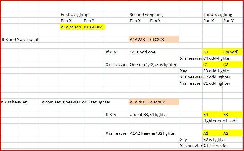

Number the coins 1 through 12.
Weigh 1,2,3,4 against 5,6,7,8.
If they balance, then the different coin is among 9,10,11,12
--Weigh 1,2 against 9,10.
--If they balance, then the different coin is among 11,12
----Weigh 1 against 11
----If they balance, the different coin is 12 (but we don't know whether it is h
eavy or light)
----If they don't balance, the different coin is 11.
--If they do not balance, the different coin is among 9 and 10.
----Weigh 1 against 9.
----If they balance, the different coin is 10.
----If they do not balance, the different coin is 9.
If they do not balance, then determine which set is lighter. Renumber the coins
so that
1,2,3,4 is the lighter set and 5,6,7,8 is the heavier set.
--Weigh 1,5,6 against 2,7,8
--If they balance, then the different coin is among 3 and 4 and is the lighter o
f the two.
----Weigh 3 against 4. The lighter coin is the different one.
--If they do not balance and 2,7,8 is heavy then either 1 is light, or 7 or 8 is
heavy.
----Weigh 7 against 8.
----If they balance the different coin is 1.
----If they do not balance the different coin is the heavier one.
--If they do not balance and 1,5,6, is heavy, then either 2 is light, or 5 or 6
is heavy.
----Weigh 5 against 6.
----If they balance, the different coin is 2.
----If they do not balance, then ...

... the different coin is the heavier one.

isly ilwott said:
I haven't counted the words as your "solution" does not describe the set-up of each weighing. You would need to do more explaining of your logic to satisfy the judges.
Your failure to recognize that this old, well-known and published procedure, besides solving your puzzle plus the immediate generalizations of it, is elegant, simple, and fully satisfying remains in my view your own problem. Frankly, I have built an explicit solution to this problem years before knowing the general solution given above. Constructing an explicit solution is straightforward and much less interesting than knowing the general solution.
If I were really bored and had nothing to do, I would display the explicit solution which comes out of the procedure, but unless I break a leg and end up stuck on a bed or something (not even sure that would be enough), for me to do so you would have to give me a good reason (besides getting your approval as "solving the problem" which I do not see as much worthy...).

After you assign each coin a three letter 'word', you create a new word by 3 weighings in the following manner. In the first weighing, you put each coin whose first letter is L on one side and each coin whose first letter is R on the other. If the L side is heavy, L is the first letter of the new word. If the R side is heavy, then R is the first letter of the new word. If they balance, the S is the first letter of the new word. For the second weighing, put each coin whose middle letter is L on one side and each coin whose middle letter is R on the other and so build the second letter of the new word. Then put each coin whose last letter is L on one side and each coin whose last letter is R on the other. When you have built the new word, compare it to the words on the coins. If it matches a coin, then that coin is heavy. If no coin matches the new word, exchange L for R in the new word. It will certainly match one of the words on the coins and that coin will be light.

The judges have analyzed your general solution and find it quite correct, though difficult to follow. You have won the overall prize, consisting of a cyber high-five and a wide smile. Congratulations! (That is, of course, less than meaningless if you googled the solution.)
For those of you who would arrange subsequent weighings patterned according to the outcome of the previous weighings, please continue to formulate your "if A then B" solution. It is substantially easier to fathom yet more lengthy when put to words.
OK, I described the problem and the solution I gave earlier to somebody else, and I must admit it does not seem so clear. So I will work out the solution explicitly below. I hope it clarifies.
Let us first write down all 27 possible strings of "L", "R" and "S" and select the 12 "good ones" according to the above criteria. I'll color the good ones in green and the bad ones in red

Now among the green good ones, I get the following table :
Code:
coin # | first | second | third
[color=red]     1 |   L   |    L   | R[/color]
[color=blue]     2 |   L   |    R   | L[/color]
[color=blue]     3 |   L   |    R   | R[/color]
[color=blue]     4 |   L   |    R   | S[/color]
[color=red]     5 |   R   |    R   | S[/color]
[color=green]     6 |   R   |    S   | L[/color]
[color=green]     7 |   R   |    S   | R[/color]
[color=green]     8 |   R   |    S   | S[/color]
[color=purple]     9 |   S   |    L   | L[/color]
[color=purple]    10 |   S   |    L   | R[/color]
[color=purple]    11 |   S   |    L   | S[/color]
[color=red]    12 |   S   |    S   | L[/color]
Now let's look at the structure a little bit and re-arrange rationally. There are 3 regular groups (2,3,4) in blue, (6,7,8) in green and (9,10,11) in purple which all do the same for the first two measurements. There is an additional "exceptional" structure with elements (1,5,12) in red which alternate in a circular permutation. Once those structures have been noticed, I decide (arbitrarily) to switch the second set of measurements : all coins on L will go on S, all those on R will go on L, and all on S will go on R. I also re-arrange the coin numbering according to the 3 groups. I re-number blue group first, then the green one, then the purple one and finally the exceptional red one.
FINAL CODE TABLE :
Code:
 old # | first | second | third | new #
[color=blue]     2 |   L   |    L   |   L   |     1[/color]
[color=blue]     3 |   L   |    L   |   R   |     2[/color]
[color=blue]     4 |   L   |    L   |   S   |     3[/color]
[color=green]     6 |   R   |    R   |   L   |     4[/color]
[color=green]     7 |   R   |    R   |   R   |     5[/color]
[color=green]     8 |   R   |    R   |   S   |     6[/color]
[color=purple]     9 |   S   |    S   |   L   |     7[/color]
[color=purple]    10 |   S   |    S   |   R   |     8[/color]
[color=purple]    11 |   S   |    S   |   S   |     9[/color]
[color=red]     1 |   L   |    S   |   R   |     10[/color]
[color=red]     5 |   R   |    L   |   S   |     11[/color]
[color=red]    12 |   S   |    R   |   L   |     12[/color]
Previous table is what I got by trial and error. Later on in an optimization algorithmic programing lecture, I learned about this method (and others, allowing to solve optimization under constraints such as "given a backpack with finite volume and load capacity, how do you optimize the objects you put in given a large set of them with different volumes, weights, and values" for instance. Anyway...). Final table below is just the procedure set you get from all this, in terms of the new coin numbering scheme
PROCEDURE
Code:
measurement |   left   |   right  |   side
      1     | 1,2,3,10 | 4,5,6,11 | 7,8,9,12
      2     | 1,2,3,11 | 4,5,6,12 | 7,8,9,10
      3     | 1,4,7,12 | 2,5,8,10 | 3,6,9,11
INSTRUCTIONS
  • Label all coins 1 to 12
  • Perform 3 weighting according to the procedure table
  • At each measurement, write "L" is left is heavier, "R" if right is heavier, "S" otherwise
  • You have a 3-letter word. If it matches a coin from the final code table, this coin is heavier
  • Otherwise, replace "L" by "R" and "R" by "L" in your 3-letter word from measurement. It will match a coin from the final code table, and this coin is lighter

Actually, I don't think the sketches are necessary. Here's my solution.
First weighing
(1 2 3 4) on left (5 6 7 8) on right 9 10 11 12 on table
If balanced, then you know that the odd coin is 9 10 11 or 12, AND that 1 2 3 4 5 6 7 and 8 are all good (G)
Second weighing then would be:
(9 10) on left (11 G) on right
If balanced, then 12 is odd.
Third weighing would then be (12) on left (G) on right with obvious determination of whether 12 is heavy or light.
Down left>12 heavy,
down right> 12 light
If the second weighing does not balance
Down left> 9 or 10 heavy OR 11 light
Then third weighing would be (9) left (10) right
If balanced, then 11 is light
Down left> 9 heavy,
down right> 10 heavy
That’s the easy part (when the first weighing is balanced)
If the first weighing does not balance, then
Down left> 1 2 3 or 4 is heavy OR 5 6 7 or 8 is light, AND 9 10 11 and 12 are all good (G)
Now remove two coins from one pan and one coin from the other pan and replace them all with G’s. It doesn’t matter which side you choose to remove two coins from. I choose to remove two from the left and one from the right. (You should easily see that the solution is quite similar if you remove two from the right and one from the left.)
Now pick any unknown coin from each pan and swap it to the other.
The second weighing is then
(1 5 G G) on left (2 6 7 G) on right 3 4 8 G on table
If balanced then the odd coin is 3 4 or 8. Since 3 and 4 are both candidates to be heavy,
The third weighing would then be (3) on left (4) on right
If balanced, the odd coin is 8 (and has already been determined to be light)
If not balanced, the heavy coin went down.
If the second weighing does not balance then
Down left>1 is heavy OR 6 or 7 is light (remembering that if 5 is bad, it is light and that if 2 is bad it is heavy...these are the two coins I swapped from one pan to the other.)
The third weighing would then be (6) on left (7) on right
Balance > 1 is heavy
Down left> 7 is light
Down right > 6 is light
If the second weighing went down on right, the 2 is heavy OR 5 is light, in which case the third weighing would be either one of them against a G.
Similar manipulations apply if the first weighing went down on the right.
see the detailed solution in attached file.
