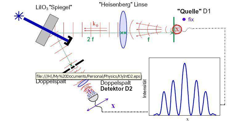

Look at the picture attached, which is Figure 4.5 from the Dopfer thesis.
D1 is fixed at the focal point of the Heisenberg lens (it does not scan its x-axis). D2 does scan the x-axis and a pattern emerges when the D1 and D2 photons are coincided.
If we could ensure that every signal photon coming out of the crystal actually hit the detector D1, would that not eliminate the need for coincidence counting?
Moving over to the image slit side does not improve potential results.
It is not that forcing D1 to collect all photons that would have entered the H-Lens will “eliminate the need for coincidence counting” the problem is it will eliminate the ability to do coincidence counting . With no ability to selectively measure photons coming through the real double slit there is no meaningful coincidence counting at D2.
Dopher confirmed that the only way to see a pattern by moving D2 is with coincidence counting with a stationary D1 that cannot exist in your new set up.
A simple classical analysis of the size of the PDC source relative to the distance to and size of the physical double slit puts that configuration well within the out of focus near field range. This is the main difference Dopher & the Backwards C set ups. Cramer can confirm avoiding the walk off issue by setting up in the far field (instead of the near field as Dopher uses) will give a pattern is the easy part for him. His technical issues with the rest of his experiment are not directly related to the near field issues shown here in Dopher.
I consider Dopher an inverse of a typical DSQE where a pattern is erased by correlations; as she builds a pattern where there was none by using correlations. IMO she deserved to have had a paper published under her name summarizing her thesis which was probable to long for a peer review publication. I assume she at least received a good grade on her thesis work.
But you're overlooking the fact that the only reason the coincidence counting is necessary is to make sure we only plot photons at D2 which correspond to photons detected at D1. The pattern that emerges at D2 is just a plot of ALL the photons that emerge from the real slit which coincide with photons that were detected at D1. The photons at D2 could have been detected in any order so long as the only ones we look at were ones that hit D1. Therefore, if ALL the photons hit D1, we could look at all the photons hitting D2 and see a pattern.

Take Figure 4.5 up there.
Assume EVERY signal photon (top half) hits D1. Ignore everything else that happens inbetween the crystal and D1. (Ignore whether this is possible for the moment).
Replace D2 with a white screen.
I expect to see interference fringes at D2.
You disagree?
You disagree?
It is necessary to use coincidence counting without it reducing the photon count at D2 to the correct few that can produce a interferance pattern is the only way to get that pattern.
Forcing D1 to read all photons and not allow D2 to reduce its count down to the correct few is the same as not counting and getting no pattern. Reread #5.
You're assuming a priori that what happens to a particular photon at D1 has no effect on what happens to its twin at D1. But I believe the Dopfer experiment confirms that this is - at least - an unproven assumption. But that is the very assumption that Cramer, et al are trying to prove. What is the basis for that assumption other than causality postulates and the so-called no-signalling theorems?

The topic of having interferences at D2 without coincidence counting is discussed in the Dopfer thesis on page 45. There it is stated, that the single photons have coherence properties, which are comparable to thermal light. Their phases are uncorrelated (just the phase for the two photon state is well defined) and will therefore usually not produce an interference pattern. However, one can increase spatial coherence by using a smaller part of the source, which means increasing the distance between the source and the double slit. On page 45 Dopfer states, that the minimal distance to have an interference pattern occur without doing coincidence counting is 770mm.
Dopfer then develops a criterium to have an interference pattern occur in the coincidence counts. She argues, that you need enough "allowed directions" for the photon pairs in order to be able to see an interference pattern. She then states, that one can only see the part of the intensity pattern, for which the needed momentums can be realized. (Sorry for the strange usage of language. The terminology in the original thesis is also a bit sloppy here.)
As an analogy she thinks of D2 as a source of photons and the nonlinear crystal as a mirror. The photons go through the double slit and are reflected towards the detector D1. Only if the distance between the crystal/mirror and the double slit is small enough, a picture of the double slit will arrive at the detector, because otherwise the mirror will be so small, that only a small part of the interference pattern will be reflected and one will not be able to see interferences anymore. She then states, that the maximum distance for interferences to occur in coincidence counting is 106mm.
She then concludes that single photon counting interferences and coincidence counting interferences are complementary in principle, so it is impossible to see both at once with full contrast. She quotes an article here (D.M. Greenberger, M.A. Horne, A. Zeilinger, Multiparticle Interferometry and the Superposition Principle,
Physics Today, 22-29 (August 1993)) and says, that it holds more information about this complementarity, but I did not check that.

Cthugha said:
I do not know, whether this hits the central point of the discussion, but let me comment on this topic by translating or at least summing up a few passages of the thesis as good as I can:
She then states, that the maximum distance for interferences to occur in coincidence counting is 106mm. .
Thanks so much.
Selective Google translations for German can be hard to sort out.
I disagree with her “Mirror” analogy – I look at it as correlations allow the PDC to act as a Pinhole Camera using D2 as a faux source when the PDC is otherwise much to large to serve as a “Pinhole”.
Taking a closer look at the German text around the 106mm statement – do you think it fair to say it means to produce a random dispersion pattern from a single PDC beam that only coincidence counting with the other PDC beam could recover an interference pattern the distance to the double slit needs to be less than 106mm?
And the range between 106mm to 707mm is kind of a fuzzy area between a clear Near-field verses Far-field condition.
Thus with her experiment using a distance of 702.2 nm from the PDC to the ‘Doppelsplat’ it is well inside the near-field range. (Even deeper than I’d thought.)
She calls her mirror analogy the Klyshko picture. I just know, that he was one of the pioneers in down conversion, but I do not know, whether this picture is just a very simplified toy model or claims to be realistic.
If I get you right, I think this is indeed what the text says.
I think the picture she used to describe her setup is a bit misleading. The 702.2 nm are the wavelength of the photons she used. The distance from the PDC to the double slit is 40mm as Dopfer states on page 45.
Thanks that is a good bit more realistic (the nm range just didn’t make sense).
