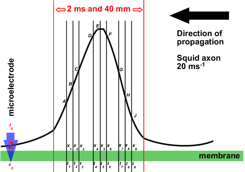

An AP (Action Potential) is traveling all along the axon for an unmyelinated fiber.
Its speed (conduction velocity) is variable and depends of the diameter of the fiber.
A Squid axon has a common speed around 20ms-1.
The duration of an AP is variable ans it is around 2/4 ms for the giant squid axon.
A phenomenon, which has a duration and travels at a known speed, occupies a length that is the result of duration*speed.
In our example we have: 40 mm (0.04 m).
If we record the AP at location Z, we get have at time t1, the value A, t2 => B and so on.
But at time t0, all values exist on the axon but located at x1, x2...
This means its exist sequences ABC, DEF or GHJ.
These sequences may be explained by the positive loop of the HH model. The HH models fits only the second one. And all exist at the same time.
The length of the phenomenon excludes also the local current process. the space constant is too short to enable any next patch.

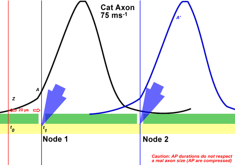

If we take, now, a common myelinated fiber (a cat one: values come from Bullock).
A fiber that has a 75ms-1 average speed. Its AP duration is measured: 1 ms.
The HH model expects the second AP (Node 2) is initiated when the AP, recorded at Node 1, reaches the A value.
This means a new AP is instantiated every 0.3 ms.
Since we know that an internode length is comprised between 1 and 2 mm, there is 500/1000 per meter.
In the worst case, we get:
1000*0.3E-3 => 0.3sm-1 => 3.3 ms-1
That is far from the expected 75ms-1
In the best case, we get:
500*0.3E-3 => 0.15sm-1 => 6.67 ms-1

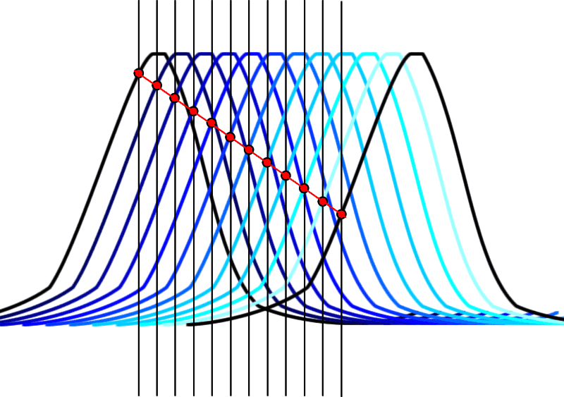

It is easy to find a solution that fits the measured values (facts).
If speed is 75ms-1 => AP travels at 75mm/ms.
If internode length is 1.5 mm, then a new AP appears at Node 51, just after 1ms.
Thus, it is mandatory that 50 AP exist at the same time.
Since the internode length is presumed constant then each AP is separated by 20 µs and the initiating value A must be much below the expected value.

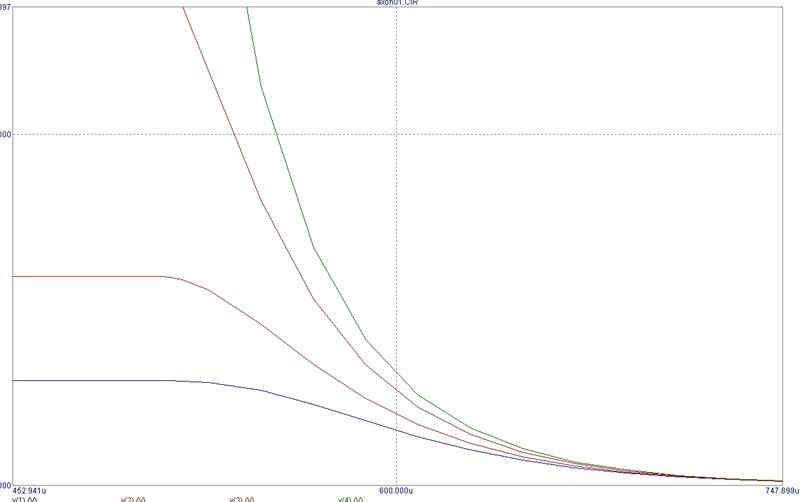

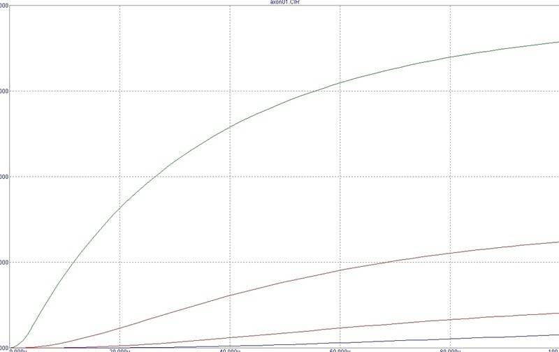

I did with this software =>
http://www.spectrum-soft.com/index.shtm
The cable model is a simple cascade of low pass filters.
It is normal that each cell fills itself with some virtual delay (at rising phase).
But if the current is shut the cells are all emptied at the same time.
It means that the duration of the initial pulse is reduced with each added cell.
This does not reflect the real situation since AP duration remains unchanged.
And, and there is no propagated delay!

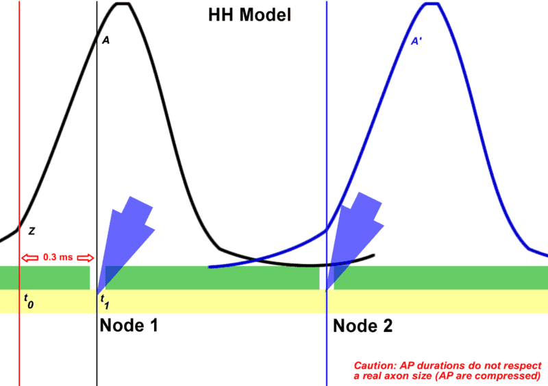

atyy said:
Then nodes #1 through #51 become inactivated for 1-2 ms, and the APs within that segment have no boosting for that period of time.
Each AP is delayed thus the first becomes inactivated when the 50# is just activated. This delay permits to the refractory period to be delayed as well.
somasimple said:
Each AP is delayed thus the first becomes inactivated when the 50# is just activated. This delay permits refractory period to be delayed as well.
I didn't understand the figure - could you give more detail?
Your prediction of approx 50 "events" along a length of axon seems reasonable, but I want to know whether you would also predict 50 APs arriving at the axon terminal - that wouldn't be reasonable, at least not if we only initiated 1 spike at the soma.
  • #31
Fact: Only one arrives. Nature plays with us!
Prediction:When an AP is initiated at a next node then the previous one must be lost. There is a simple and anatomical explanation.
I'm was actually working on the drawing...
