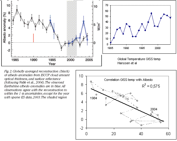

Perhaps have a look at this older thread.
Note that the link to those graphs is broken, but here they are:
Note that in essence the albedo varariation corrolates very well with recorded temperatures, although the amount of data is too limited to make firm conclusions.
0 to 60 is a really large change in Albedo. I think you'd be surprised to find that that wasn't correlated with temperature. Does that really mean a range as wide as 0% to 60% of the incoming solar irradiation reflected?
However, this does not contradict that albedo has contributed only in a minor way to the current global warming ... unless there is also a strong trend towards decreasing albedo since the middle of last century.

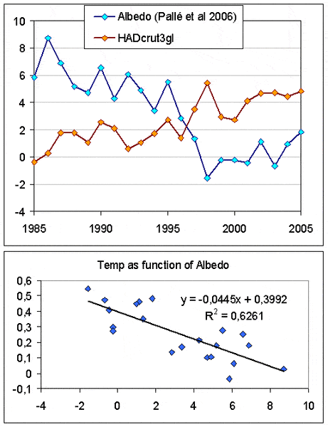

Sorry my bad, I mixed up the X and Y in the X-Y scatterplot.
So decided to do it again:
Again, The albedo variation is digitized from Pallé et al 2006, (fig2) variation in %. The global temperature variation in tenths of degrees in in top graph is from the file HADcru3gl issued by the Hadley Met office in the UK
Sources:
http://www.iac.es/galeria/epalle/reprints/Palle_etal_EOS_2006.pdf
http://www.cru.uea.ac.uk/cru/data/temperature/hadcrut3gl.txt
Although things are much more complicated but an r2 of 63% should not be dismissed that easily, should it?
