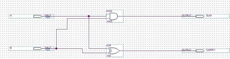

Sorry to do this but I have got stuck again.
Firstly for some reason my Subtraction circuit is bringing up errors (I am using Quartus) for no reason (picture below).

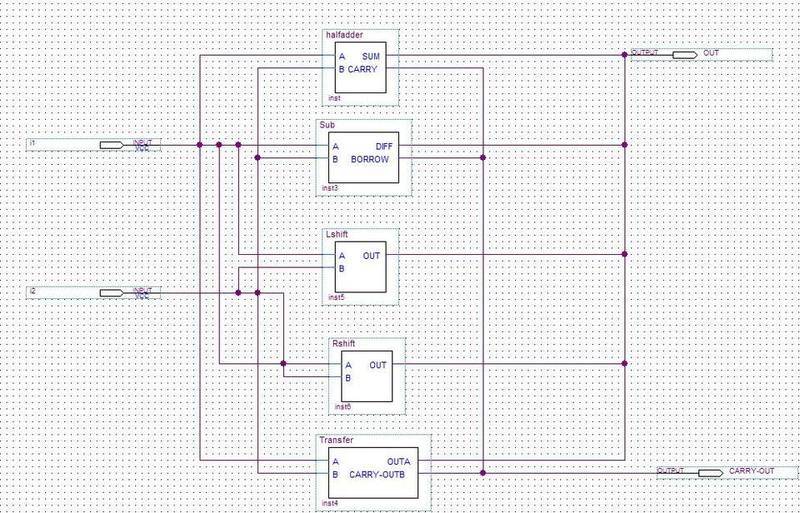

Secondly I have built the circuit but I have no idea where to go from here, how to turn it into what is below into a full ALU. Anyone got any good tutorials for Quartus on how to do this? (first time using Quartus for me).
Lastly I need to use flags (or Status Bits) for Zero, Overflow and Negative. Can anyone understand this as I couldn't find it in the lecture notes?
Thanks for all the help so far. Everything I have so far is below, I have it in Quartus file type as well if anyone wants to have a closer look (let me know).

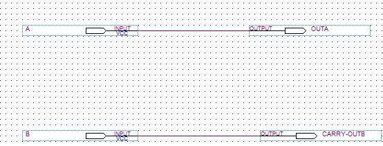

Oh and also we are only meant to use primative Logic gates, that is why I didn't use a Shift Register.
Adding:
Transfer:

Full ALU:
Subtracting works by adding a complement of one operand to another. That means you need to put an inverter at one of the inputs of the adder.
As far as shifting bits, are you allowed to use flip-flop?
Nope, only basic logic gates like AND, OR, NOT, XOR etc.
