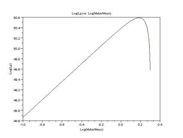

APPENDIX 4 -- Total Planetary Angular Momentum (Lp)
O/B/A-Class stars do not produce Planetary Systems. For, less massive stars have significantly less Specific Angular Momentum (L/M*) than their bigger & brighter counterparts. But, by adding in the planets' angular momentums, the Sun (at least) then has (essentially) the expected Specific Angular Momentum. Thus, the "angular momentum deficit" of F/G/K/M-Class stars suggests that the "missing momentum" has been deposited in Planetary Systems*.
* Carroll & Ostlie. Introduction to Modern Astrophysics, pg. 891.
From the information provided, I calculated to Total Planetary Angular Momentum (Lp [cgs units]) as a function of star mass (M*/Msun). The result is plotted in the attached figure. Stars of ~1.5 Msun (~F5-Class) are predicted to deposit the most Total Planetary Angular Momentum, ~1.5x that of the Solar System. Precisely these stars are the most "precocious" (see Appendix 3), most rapidly developing Complex Life, perhaps ~1 billion years more quickly than on Earth.
