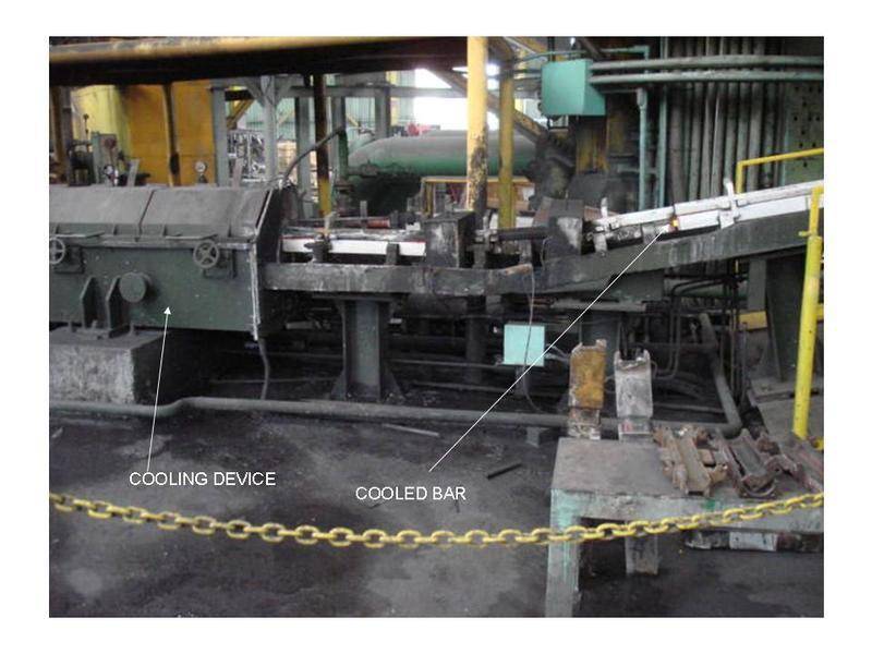

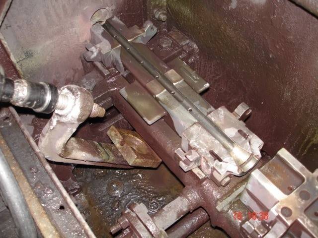

There is steam generation; but I don´t think it´s very abundant. I will get a picture for you tomorrow, so you can see this. Meanwhile, take a look at the one I´m attaching. Here you see the conduct and the holes for the water.

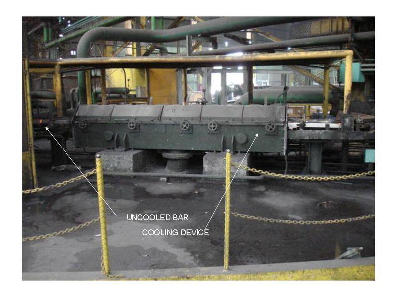

Here are the pictures showing the device in operation.
