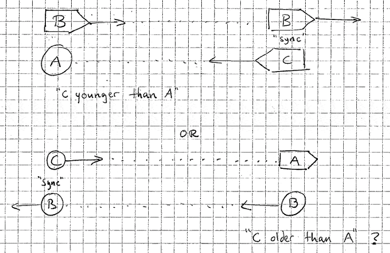

If I place Betty in a rest frame in which she sees Alfred move away with the Earth and stars and everything, and then Alfred comes back again with the Earth and everything, how can I claim that this is any different from seeing Alfred at rest during the whole thing?
The relative velocity-argument from "12 JesseM" is, imho, reversible, since I just changed the names of the persons and their vessels, sort of. But I am also convinced that it isn't, so I need to find out what the difference is...

But I don't need the concept of acceleration to see that there is a change of frame for Betty at the turnaround. I can simply let her synchronize her clock with a third person who seems identical to Betty in Betty's outbound frame at the event of synchronization although she's moving in the opposite direction.
Why can't I change the name "Betty" to the name "Alfred" without changing her age at the reunion?
If I remove the earth, I can place Alfred in a spaceship where the Earth "used to be". How can Betty tell that it's not the Alfredian spaceship which is moving, changing frame and returning?
Why do we need the concept of acceleration to explain why her frame is non-inertial, if there is no such thing as an absolute space in relation to which one accelerates? That is, Betty needs to accelerate to return to Alfred, yes, but Alfred has to return to Betty in the other point of view, how can he do that without accelerating? Why is he returning without changing frame?
If there are three people involved as above, how can we tell that there are two Bettys and not two Alfreds?
I can calculate the dilations in the respective frames, but if I code the A, B and C on my gamma on my paper, I cannot tell which letter "actually" is which frame, so I cannot distinguish Alfred at rest all the time [where he moves away all the time and halfway meets an identical Alfred moving in the opposite direction] from the one where Betty is at rest all the time [where she moves away all the time and halfway meets an identical Betty moving in the opposite direction

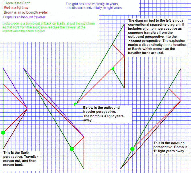

Yes, it does change immediately at turn around. It changes immediately at turn around in precisely the same way as the direction to the other twin changes immediately at turn around.
If you switch from 60% light speed outbound, to 60% light speed inbound, the angular size of the objects in your direction of motion change instantly by a factor of 4, reflecting their new distance in the new reference frame. Recall that the size of an object in the sky depends not on the "current distance", but the distance that has been traveled by the photons now reaching you.
As you return back towards Sol, it will grow steadily in apparent size, consistent with Sol's velocity (in your frame) of 60% light speed.
Acceleration is not required. This is another common mistake. Acceleration is not what matters. It is the turn around, or the change of perspective, that matters. The same thing would happen if you use a teleporter to move from an outbound Enterprise to an inbound Klingon freighter, with no accelerations involved. You don't even need to transport... you can just communicate with a friendly passing Klingon. If you are headed out from Sol, at 60% light speed, and they are headed towards Earth at 60% light speed, then the solid angle subtended by Sol will be four times smaller for the inbound Klingons than for you, outbound. That's because it is further away in their reference frame than in yours.
Cheers -- sylas

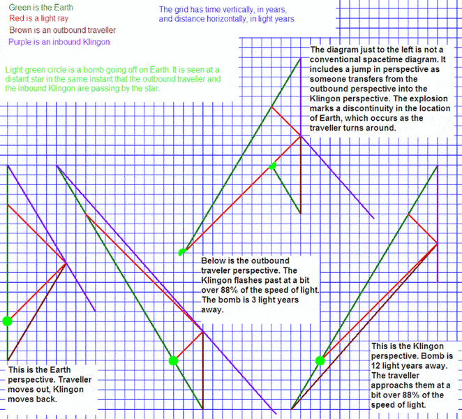

You can just communicate with a friendly passing Klingon. If you are headed out from Sol, at 60% light speed, and they are headed towards Earth at 60% light speed, then the solid angle subtended by Sol will be four times smaller for the inbound Klingons than for you, outbound. That's because it is further away in their reference frame than in yours.
But that doesn't say anything about why it is not the Earth that is communicating with a friendly passing Earth with a klingon on it. Then the far-away spaceship would be different in size depending on whether you are the "original" earthling or the klingon. You say no, I say why?
I know I'm wrong, but I don't feel where the difference is. And I don't know if you understand what I'm looking for either... :)
If I draw a pic of the situation, I can replace the triangles symbolizing the spaceship frames in relative motion with circles symbolizing earth-frames in relative motion, and the circle symbolizing the earth-frame at rest with a triangle symbolizing a spaceship frame at rest.
The difference between communication with a passing Klingon and a Klingon at a great distance is that you can no longer treat communication as a single well defined event. It is the event of transmission, and then another event of reception, some time later. Further more, the distance traveled by the photon for a given communication will vary depending on who is measuring it.
Hence you can synchronize your watch with a passing Klingon, but not with a distant Klingon.

I don't know what's going to work best for you. Everyone is different. Personally, I have found space time diagrams very useful. You can do a diagram where Earth is stationary, or where the outbound ship is stationary, or where the inbound ship is stationary. Or you can use a passing Klingon with a totally different velocity of their own. All the diagrams can show the same events and calculate the same "proper time" elapsed between events for any of the travelers.
If you don't like diagrams, then you could use the Lorentz transformations.
What you can't do is hold on to your current intuitions. You are going to need to retrain your intuitions to match what is really happening at high velocities.
Cheers -- sylas
  • #33
Yes, but I never mentioned any distant klingon. So far it seems that we have concluded two apparently identical situations which are different:
1.
Spaceship-klingon moving in the opposite direction from me with whom I sync my watch in the frame where I move away from the Earth should see the distant Earth at a different angle than I do.
2.
Earth-klingon moving in the opposite direction from me with whom I sync my watch in the frame where I move away from the spaceship should NOT see the distant spaceship at a different angle than I do.
The only thing that differs from the points of view is the placement of the words "spaceship" and "earth", which have changed places.
This redefinition of the words induces a "NOT" in the second situation. How is this possible to defend without calculations? And how is this possible to defend with calculations? Why do the calculations (or spacetime diagrams) take into account the definition of the words "earth" and "spaceship"?
  • #35
1.
This is what happens.
2.
This doesn't happen. A Klingon passing by the Earth at high speed WILL be in a different frame to the Earth, and will be at a different distance from any other remote events by comparison with Earth-bound observer. Even though they are at the same place and time.
Distances and times to remote events depend on your velocity, as well as your location in spacetime.
All you've done wrong is presume that the Klingon passing by the Earth will see things at the same size, and distance as someone on Earth. They won't. Different frame, different distances and times for remote events.
Cheers -- sylas
