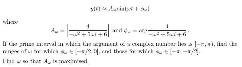

For this I started with the 1st interval [0,pi/2] and said
arctan [4/ ... ] = [0 , pi/2]
but studying the tan graph this is all positive values of the y-axis
so surely the range of values for this is (0 , inf)?
If I've done that right, how do I do the other interval [-pi/2 , pi]?
Because using that method gives the result (-inf , 0), but then that would also be true for the quadrant [0 , -pi/2] surely, which brings me back to my first answer also being true for [pi/2 , pi]..
How do I attempt this because this is obviously wrong..
This was under the chapter about Laplace / Fourier Transforms
And if you could shed any light on how to maximise too I'd be greatful, because my notes havn't touched on this..
The y(t) = ... was formed from solving a differential equation using laplace transforms, I didn't include that because I didn't think it was relevant. =)

Oh shoot I read the question wrong =)
I mean for [-π/2 , 0]
So I guess that's the values for (-inf , 0)..
AH yeah I see now I was doing something wrong in my method too
So how I'm interpreting the question is this:
Where does the angle given by arg[4/-ω2+5ωi+6] lie in the bottom right quadrant [-π/2 , 0] of an argand diagram?
So do I need to change [4/-ω2+5ωi+6] into the form x + iy?

No, it's asking what are the values of ω for which 4/3 lies in the bottom right (4th) quadrant? (and then same question for the 3rd quadrant).
Yes! :smile: (or you'll end up in the wrong quadrant :rolleyes:)

I canceled it all down and got my
arctan 5ω/(ω2-6) (lets assume this is right, forget my working too much to type out :P)
then 5ω/(ω2-6) has to lie in (-inf,0) for my arctan 5ω/(ω2-6) to equal the interval (-pi/2 , 0)
so how do I find ω from this?
This is getting unnecessarily complicated …
you don't actually need to consider tan-1 since all you are interested in is the quadrant, which means all you need to consider is the signs of x and y (in x + iy) …
just draw the four quadrants, and mark them ++ +- -+ and -- :wink:

now I got it! ty. Much simpler, and I have myself an answer
Any idea of how to maximise? because that part has me stumped
just maximise x2 + y2 :smile:

Well I was using my x+iy values
I then found x^2 + y^2
and I got ω^4 -12ω^2 +61
So I'm trying to find the value of ω where this is largest, and by the graph it zooms off the screen so I was assuming inf and -inf for my ω
No, it's 1/(that) …
(except you've used 25 instead of 25ω2)

My x2+y2
= 16(ω4-12ω2+61)/(ω4+13ω2+36)
Do I just draw this graph?
It shows a maximum at ω=0
But as ω tends to -inf and +inf then the graph tends to +inf
So is my answer ω = +- inf
Or ω = 0? :)
Hi Firepanda! :smile:
I'm getting confused :confused:
|1/A| = 1/|A|, so isn't it just 1/(ω4+13ω2+36)?
(and you can factor that :wink:)

I meant I don't see where your fraction (ω4-12ω2+61)/(ω4+13ω2+36) comes from :confused:
EDIT: my working out was riddled with mistakes so ill just put the answer!
I seeeeee!
Woohoo
16/(ω4+36+13ω2)
I have the roots of the denominator, what do i do with those?
Firepanda said:
= 4(-ω2+6-5ωi)/(-ω2+6-5ωi)(-ω2+5ωi+6)
Ah I see now I didn't square the denominator :P
Woohoo
16/(ω4+36+13ω2)
he he :biggrin:
now you see you were going round in circles … |1/A| = 1/|A| ? :smile:
hmm :rolleyes: … on second thoughts, factoring doesn't help … the roots are all imaginary, which is a teeny bit irrelevant since ω is real :redface:

How do I complete the square with this? 13 is odd so when I do
2+b)2 = b2 + c
What is b?
try (ω2+b)2 + c, with b = 6.5 :wink:
