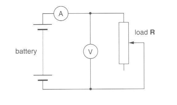

Graph to show the variation of the p.d. V across the battery with current I as R is varied.
i) Draw line of best fit.
ii) Use it to determine the emf of the battery;
and the internal resistance r of the battery.
The gradient [itex] \approx \frac{\Delta V}{\Delta I} = 1.67 \Omega [/itex]
Just don't know what to do really. Need an example and explanation of the concept.
Let the internal resistance of the battery be r.
The same current,I, passes through both r and R right?
So by Kirchoff's 2nd law
the emf of the battery=sum of the pd's around the loop
If V is the pd across the load then
E=V+Ir.
Since they plotted V against I, rearrange the equation it in the form a straight line y=mx+c
you calculated the gradient correctly to give a resistance. So rearrange the equation and you will see what that gradient represents and what the intercept represents as well.
[itex] V = f(I) [/itex]
[itex] V = -Ir + E [/itex]
y-intercept is emf, gradient is -r. Thanks.
