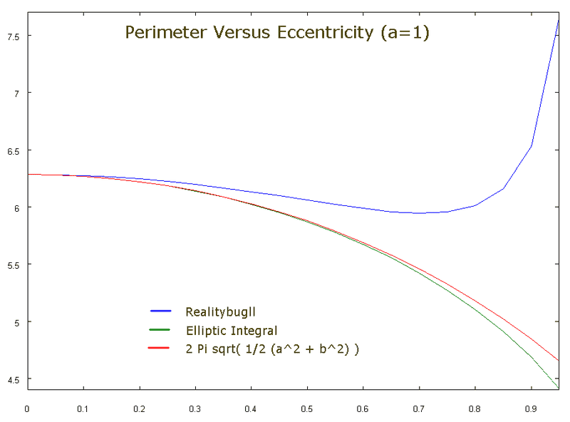

Hi realitybugll. Your formula can be simplified a lot, with a bit of algebra it reduces down to :
[tex]b (\alpha^2+1) (\pi/2 + 2 \cos^{-1}(\frac{\alpha}{\sqrt{1+\alpha^2}}) )[/tex]
Where [itex]\alpha = a/b[/itex]Unfortunately however it isn't even a good approximation, let alone an exact expression, for the perimeter of an ellipse.
The attached image shows the perimeter versus eccentricity for your formula against some other methods (the elliptic integral method being the "exact" value).

OK then there's still something wrong with how you have expressed you formula in post #5 then.
[tex]4{\frac{\frac{(a^2+b^2)\frac{1}{b}\pi}{4}}{\frac{\sin^{-1}(\frac{a}{\sqrt{a^2+b^2}})-45}{90-(\sin^{-1}(\frac{a}{\sqrt{a^2+b^2}})-45)}+1}}[/tex]
If you substitute a=7 and b=2 into that you get approx 56.4 (not 29.5), so it seems you still need to post the corrected formula.

Ok we agree on the numerator but could you show me how you're getting 2.822 for the denominator.
I get :
[tex] a/\sqrt{a^2+b^2} = 0.9615 [/tex].
[tex] x = \sin^{-1}(a/\sqrt{a^2+b^2}) = 74.06[/tex] degrees.
[tex] \frac{x-45}{90-(x-45)} + 1 = 1.4767 [/tex]
So that's 1.4767 for the denominator which gives the overall value of the formula as 83.252/1.4767 = 56.376.
I still think you have posted a different formula than the one you are evaluating.
BTW. If you use my equivalent formula then you'll need to use radians instead of degrees for the inverse sine ok.
Ok, from your numbers I think I can guess what you're doing differently. You see that convoluted denominator within a denominator that you're using. You obviously aren't including the "-45 in that sub-donominator (denominator within the main denominator). Sorry to say this but it looks like you really need to learn some basic algebra skills there realitybug.
Anyway, if I remove that second "-45" from the sub-denominator then I get the following algebraic simplification of your formula :
[tex]4b * (\alpha^2 + 1) \, \cos^{-1} \left( \frac{\alpha} {\sqrt{1+\alpha^2}} \right)[/tex]
Where [itex]\alpha=a/b[/itex] as before.
AND remember that you have to use radians for the inverse cosine here.
This is a much better approximation than before, but still inferior to the simpler approximation I gave in the previous attachment.

You were right: i was evaluating it with a different formula -- i posted it wrong
this is what i meant:
[tex]4{\frac{\frac{(a^2+b^2)\frac{1}{b}\pi}{4}}{\frac{2({\sin^{-1}(\frac{a}{\sqrt{a^2+b^2}})-45)}}{90-2{(\sin^{-1}(\frac{a}{\sqrt{a^2+b^2}})-45)}}+1}[/tex]
This is different than the formula that you get if you just remove the second -45
can you evaluate this one like you did the other (wrong) one :smile:?

It turns out I didn't know what exactly an ellipse was...this formula is for a "lens"
So i am wrong. But at least now I know the difference...
