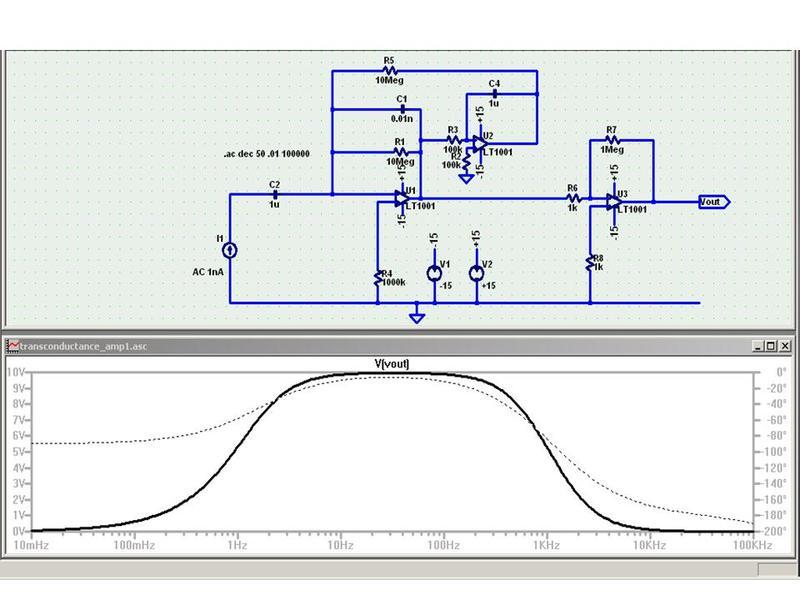

Here is a transimpedance amplifier with a gain of 10 megohms (10 millivolts per nanoamp) (see thumbnail) that stabilizes the DC drift with feedback. I decided to use a second op amp to do the stabilizing. The passband is from about 10 Hz to 200 Hz. The passband limits can be adjusted by changing resistors or capacitors.
Bob S

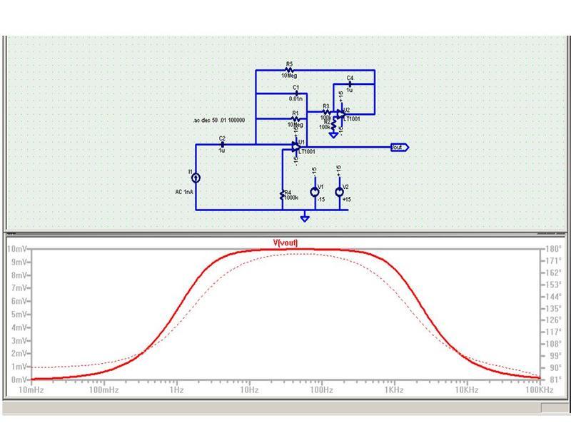

Here is another transimpedance amplifier similar to the one above, except that I have added a 1000:1 voltage amplifier on the end to give an overall gain of 1010 ohms (10 volts out for 1 nanoamp in). The bandpass is unchanged. There probably should be a pot (not shown) on the afterburner to adjust the dc quiescent voltage. As before, there is a feedback circuit on the first amplifier to zero the dc output. This is a LOT of gain, so your EM shielding has to be very good. You should consider bypassing your +/- 15 volts right where it comes through the case. Use feedthroughs if possible. You could also reduce the gain of the first amp by a factor of 10 to get rid of the 10 meg resistor.

Thanks for all the replies, they really help. I've been looking for some low TCR and instrument grade components but having some difficulty finding them in the higher values I require. However, I've found some precision resistors with a TCR of +/- 50ppm/C and tolerance of 1%. Would this be considered instrument grade? I also found some praylene caps on mouser as well that looks like they will be perfect. I just have to be cautious when soldering them to the PCB.
Bob S, thanks for the schematics. My circuit is similar to the second one you posted except for my second op-amp is in series and not cascaded. I couldn't get my pre-amp stable in that configuration. Also, I don't have the cap in series with my photodiode or the 10M resistor on the inverted input. The cap (or even a jumper) causes to much distortion in my signal and the 10M resistor adds to much noise.
One thing you had mentioned was including a pot to adjust the DC offset. I originally had a pot on my circuit for this purpose but switched it with fixed value resistors. I'm wondering if it would be better to have a pot that I would "zero-out" every time I use the circuit or if I should have fixed value resistors instead. The pot would probably be ideal and theoretically it shouldn't affect the calibration if its always zeroed out but I don't know how it will affect the repeatability of the circuit in practice.
Topher925 said:
Bob S, thanks for the schematics. My circuit is similar to the second one you posted except for my second op-amp is in series and not cascaded. I couldn't get my pre-amp stable in that configuration. Also, I don't have the cap in series with my photodiode or the 10M resistor on the inverted input. The cap (or even a jumper) causes to much distortion in my signal and the 10M resistor adds to much noise. .
I am not sure what you mean by op amp in series and not cascaded. Having the cap in series with photodiode blocks all dc current. Maybe you want to amplify dc current also? Or is your signal 50 Hz or 60 Hz only? The 10M or similar resistor on inverting input is required to convert input current signal to a voltage output signal. The extra feedback circuit is there to block all low frequency signals (under 1 Hz). What is your circuit?

To limit noise, the whole circuit, including the pot on the afterburner, should be inside a shielded metal enclosure. Once you set it, the drift in the afterburner should be small. The active feedback loop on the main amplifier should be adequate to control dc drift on main amplifier.
Thanks for mentioning that your signal come from a photodiode. Is this a vacuum photodiode, or a solid state photodiode? solid state photodiodes are more likely to have leakage currents, and maybe Schottky (diode) noise currents also.
[Edit] I reran the Spice simulation with the series capacitor on the current source (photodiode) removed, and with a shunt 100 pF capacitor on the current source. No change on the simulation ac response shown on earlier post.

Sorry such a late reply, I've been rather distracted lately. I'm actually measuring a DC signal, not AC (sort of square wave, no negative voltage). So having that cap in series with the photodiode causes a bit of a problem. Also, being as I need to measure the current output of the photodiode, any slight change in capacitance or stray leakage of that cap would cause some repeatability issues I would think.
I'm using a solid state photodiode and it is my main source of noise. My circuit is about 40-50Hz, but any change in its attenuation of the signal is unacceptable. Currently, the circuit has no EMI shielding except the steel plate in which the breadboard is mounted on and the noise is at acceptable levels. If I include any more caps or resistors like a low pass filter the noise level increases, especially the high frequency (1KHz up).
I got my high tolerance and low TC components in and installed on the breadboard. This includes 10pf polypreylene caps and somewhat large metal film resistors. I've tested the circuit several times over the past few days and I have found there is still a very small amount of drift. Its difficult to tell what's its actually from the circuit, the power supplies, or the breadboard. The power supplies I'm using like to wonder in a +/-100mV range and I'm going to assume I'm going to have leakage in my breadboard since I'm dealing with high impedences and low currents. All of the photo-detector circuits that I have seen online that use solid state photodiodes say to mount the photodiode, feedback resistor, and cap on teflon terminals to minimize stray leakage. Are PTFE PCBs typically a lot more expensive than the usual FR-4 boards?
