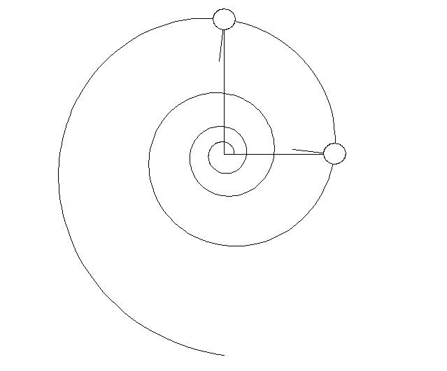

I'm trying to wrap my head around angular momentum using the following setup:
There's a ball on a frictionless table that's connected to a string. The other end of the string is connected to a hole in the table. In the initial position the ball spins around the hole.
Now, we start pulling the string through the hole and thus shortening the amount that's connected to the ball.
From conservation of angular momentum the ball is now spinning faster because it's radius is smaller. Now, angular momentum is conserved because the force of the string only pulls the ball towards the center. But in that case, what causes the angular velocity to increase?

daniel_i_l said:
even though the force is radial
The force is radial, but not perpendicualr to the spiral path of the ball that occurs when the string is pulled in or released out. There's a non-zero component of force in the direction of the ball, which speeds up (or slows down if tension reduced) the ball.
Here's a diagram, showing a short line segment perpendicualr to the ball and the radial string.

So if the radius is decreased by 1/2, the speed is doubled and the tension increased by a factor of 8.

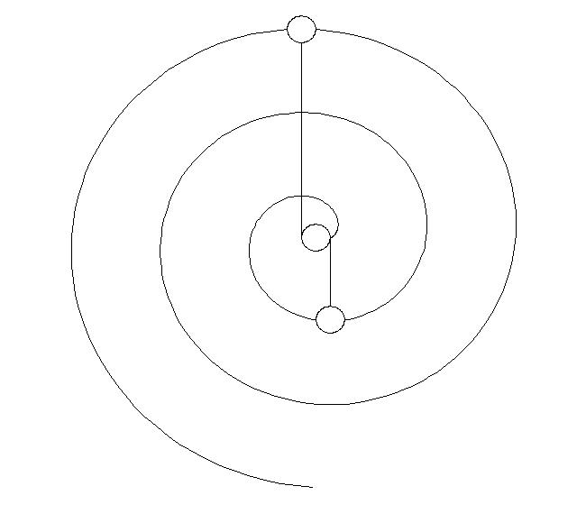

If the goal was to keep the speed of the ball constant, this can be accomplished by having the string wind or unwind from a pole. Here it appears that angular momentum isn't being conservered unless you note that the tension of the string on the pole exerts a torque on whatever the pole is attached to (usually the earth), and only by considering what the pole is attached to will angular momentum be conserved. In this case the force is not radial, but it is perpendicular to the path of the ball:
The math demonstrating that the line perpendicular to the path of the ball is the same as the tangent line to the pole is shown here:
https://www.physicsforums.com/showpost.php?p=1435942&postcount=32
