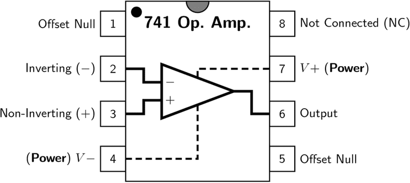

I think the confusion the OP and yourself have is in what signal is amplified. The DC voltage is used to power the op-amp, and is not the signal that is amplified. Refer to the image below:
The signal to be amplified will be an AC signal and will be fed into the op-amp through pin 2 or 3. Your Vcc +/-9V will be attached to pins 7 and 4. The amplified signal will come from pin 6 and will be the same as the signal that was input at 2 or 3, but with a greater magnitude.
In order to amplify the signal, you have to provide some form of power from pins 7 and 4. You don't get to create a bigger signal out of nothing. But if you figure out how to do that, let me know and we'll go get rich.
