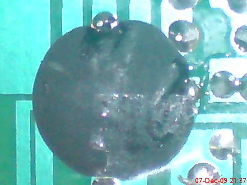

What is this ( the black colour one )?
That is an integrated circuit. They are made like this in cheap, mass produced equipment.
I have seen one in a digital thermometer.
They look like a blob of plastic, but they are fairly immune to vibration and moisture. However if they failed, the whole printed circuit board would have to be discarded.
Just to add a little bit to vk6kro's post -- it's called "chip on board", or COB. It's a technique for assembling an IC die onto a PCB, without first injection molding the die into a plastic package with leads, and soldering that onto the PCB. As vk6kro says, it is used in high-volume manufacturing of inexpensive devices, generally, and does not offer any rework capability.

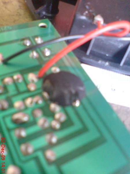

this one ! What is this ?
Yes, that one. It is an integrated circuit.
