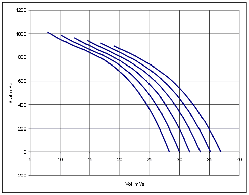

My two starting polynomials both go to f(x) = 0 at the maximum limit of x. My attempts at interpolation all go down well below 0.
I've attached a couple of pics to make it easier to understand. The first shows simple interpolation of values, all nice and neat, just what you'd expect. The second is done by interpolating the coefficients. This shows it pretty clearly - they're not a million miles away, but they're obviously not right.

I don't know if you're still here Joe, but now that those attachments are visible it is clear that the one you're doing manually (blue) is dividing the intervals along the "x" axis while the one you're doing via the coefficients (red) is (as expected) dividing the intervals along the "y" axis.
Can you explain why one (equal divisions along x axis) is preferable to the other (equal divisions along y axis)?

Now that you've said it, it's obvious... thank you! The reason that one is right is that division across the x-axis is what you get by experiment. These are performance curves for variable-pitch fans, Volume Flow along the x-axis and Static Pressure along y. We have pretty much infinite combinations we can set them to, so we can't test everything, and I need a way to manipulate the equations rather than data values.
Is it even possible to interpolate along x in this way?

No that will ultimately just get you the red curve again.
If you're sure that the blue curve is the one that has the correct physical meaning for your application then there's really no other way than inverting your equations (either algebraically or numerically), so that you can calculate Flow for a given Pressure rather than the other way around.
Like this for example.
- For a given Pressure find Flow_15 and Flow_20.
- Now form Flow_16 = 0.8 Flow_15 + 0.2 Flow20 and so on.
These are your new x values all corresponding to the same value of y (as in "for a given pressure" in the first step). You have to repeat this for each different pressure level that you wish to plot.

Well... it didn't!:confused:
I've ended up with identical data values to when I produced the blue curves.
Initially I did get the same as the red curves, but I was using values of [itex]x_{16}[/itex] in the second equation instead of [itex]x_{15}[/itex] and [itex]x_{20}[/itex].
I don't trust my maths enough to do this kind of thing theoretically, which is why I always end up producing curves and stuff, but it seems to have done the trick!
