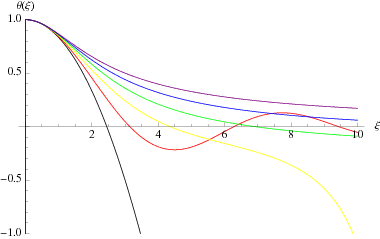

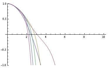

expansion series equation...
ref. 1 - pg. 46 said:
For other values of the polytropic index [itex]n[/itex], it is possible to develop a series solution which is useful for starting many numerical methods for the solution. The first few terms in the solution are:
[tex]\theta_n(\xi) = 1 - \frac{\xi^2}{6} + \frac{n \xi^4}{120} - \left( \frac{8n^2 - 5n}{15120} \right) \xi^6 + \; \text{. . .}[/tex]
However, none of the reference provide an explanation as to how this equation solution was derived.
Unfortunately, when I plot this solution for all polytropic indexes from 0 to 5, the graph does not match the correct functions, listed as first attachment.
ref. 2 - pg. 707 said:
Power series solutions about [itex]\xi = 0[/itex] are given, to facilitate such computations, according to Sugimoto:
[tex]\theta_n(\xi) = 1 - \frac{\xi^2}{6} + \frac{n \xi^4}{120} - \frac{n(8n - 5)}{42 \cdot 360} \xi^6 + \frac{n(122n^2 - 183n + 70)}{42 \cdot 360 \cdot 216} \xi^8 \; \text{. . .}[/tex]
Unfortunately, when I plot this solution for all polytropic indexes from 0 to 5, the graph does not match the correct functions, listed as second attachment.
The correct functions are listed in third attachment.
Reference:
http://ads.harvard.edu/books/1989fsa..book/AbookC02.pdf"
http://www.mpa-garching.mpg.de/~weiss/Cox_Vol_II_CD/ch23.pdf"

Express the Lane-Emden differential equation in the form:
[tex]\frac{d^2 \theta}{d \xi^2} = - \frac{2}{\xi} \frac{d \theta}{d \xi} - \theta(\xi)^n[/tex]
We have the boundary conditions at the center:
[tex]\frac{d \theta}{d \xi} = 0 \; \; \; \theta(\xi) = 1 \; \text{at} \; \xi = 0[/tex]
We calculate starting values using a series expansion for small [itex]\xi[/tex]:
[tex]\theta(\xi) = 1 - \frac{\xi^2}{6} + \frac{n \xi^4}{120} \; \text{. . .}[/tex]
[tex] \frac{d \theta}{d \xi} = -\frac{\xi}{3} + \frac{n\xi^3}{30} \; \text{. . .}[/tex]
Can anyone here demonstrate how this series expansion was generated?
Reference:
http://www.astro.uu.nl/~pols/education/stev/practicum/practicum2.pdf"
