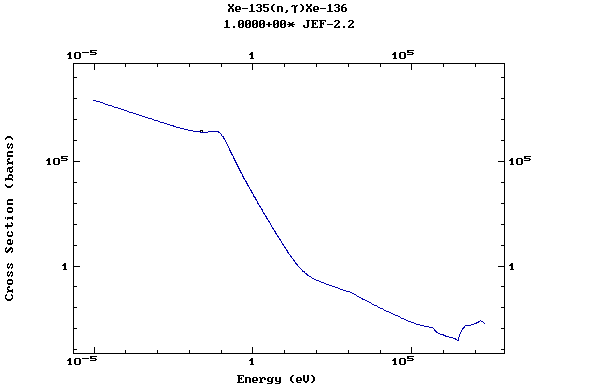

.. with all "useless" absorptions (as Astro says, in the poisons, in the minor actinides, ...), to have an ongoing breeding if you waste a serious part of your neutrons in the ashes ??
I think that's where you may be off. With a fast spectrum, absorption by products is much less of a factor. Edit: The absorption by Xenon-135, a high yield product, falls off seven orders of magnitude from thermal to MeV neutrons*, but I see the important issue is the ratio of Xenon capture to Pu-239 fission (or U-239 -> Pu breeding) with fast neutrons and I'm not sure about those ratios.
