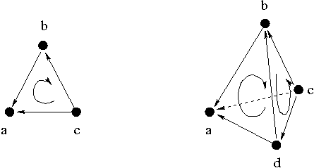

Here, the boundary maps can be labeled
[tex]
\begin{array}{rcl}
\partial_1 & = &
\left[ \begin{array}{rrr rrr|l}
ab & ac & ad & bc & bd & cd & \\
\hline
1 & 1 & 1 & 0 & 0 & 0 & a \\
-1 & 0 & 0 & 1 & 1 & 0 & b\\
0 & -1 & 0 & -1 & 0 & 1 & c \\
0 & 0 & -1 & 0 & -1 & -1 & d
\end{array} \right], \\
\partial_2 & = &
\left[ \begin{array}{rrrr|l}
abc & abd & acd & bcd & \\
\hline
-1 & -1 & 0 & 0 & ab \\
1 & 0 & -1 & 0 & ac \\
0 & 1 & 1 & 0 & ad \\
-1 & 0 & 0 & -1 & bc \\
0 & -1 & 0 & 1 & bd \\
0 & 0 & -1 & -1 & cd
\end{array} \right]
[/tex]
So for example (see the figure below)
