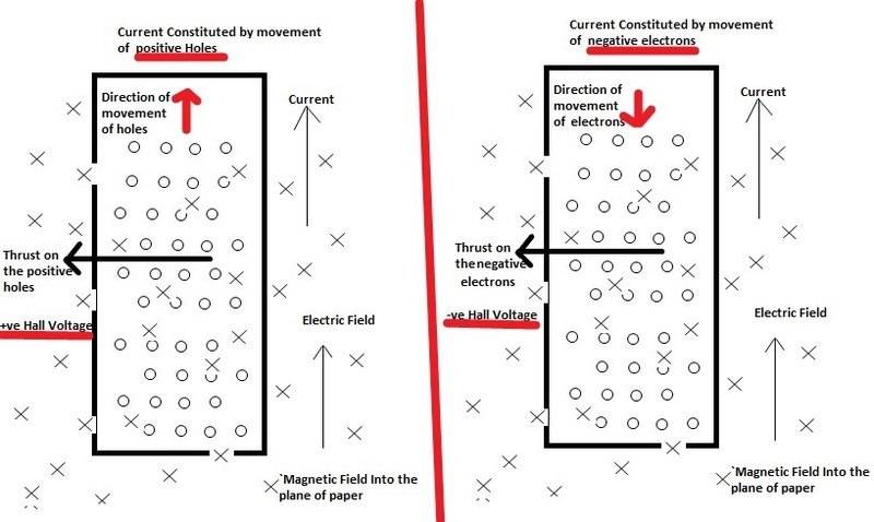

I never actually understood what exactly is a Hole? Could you explain it clearly.

I don't think that's correct. Look at the following illustration I sketched
If the movement of holes were actually movement of electrons, then should always find -ve hall voltage (Right Figure) . Shouldn't we?

In post#6 you have a contradiction.
This is because you are trying to show the current in three different ways
That is not a good idea.
You have shown a conventional current. This current is in one direction only, regardess of the movement of its carriers and is one of the determining vectors of the Hall voltage.
This conventional current arrow may be made of all holes, all electrons or a mixture.
Regardless the arrow is still the same.
So the two important vectors in your diagram are the magnetice field and the current (with its associated electric field of course).
This leads to build up of negative charge on the left and positive on the right which in turn makes the polarity Hall voltage, developed across the section negative on the left and positive on the right.

The derived force vector is correct in the right hand diagram but should be reversed in the left one as positive and negative charges are deflected in opposite directions.
Yes, I have considered that positive and negative charges are deflected in opposite directions; but since their direction of motion is also opposite; they are finally deflected in the same same direction, as shown in the figure (post 6).
Either you missed it or I am in serious trouble with the Left-Hand Rule.
But your current vector is the same in both diagrams.
The LH rule expects this vector (as you have it) irrespective of the polarity of the carriers.
This is a sign convention thing. You also have to start introducing -ve signs into the vector cross product if you must use charge carrier direction. Don't forget that the current vector also defines a direction in space, ahich you have chosen by using conventional current (wisely in my opinion).

Yes you have shown the electron and hole flow in opposite directions.
Your diagram in post 6 is both correct and compatible with vin300 statement in post 5.
The Lorenz force pushes both carriers to the same side. This is fairly easy to show mathematically.
As a result the Hall voltage across the section will be either positive or negative on the left depending upon whether the flow is holes or electrons.
This situation when there are both carriers present (semiconductors) is much more complicated. It is not true to say that just because there are more holes or electrons the left side will end up more positive or more negative. This is because the Lorenz force equation has to be modified to take into account the diffeent mobilities of holes v electrons. This can lead to the minority carrier determining the Hall voltage polarity.
You can have the equations if you want them, but it is a lot of algebra.

First let us look at the model you are employing in post#6.
The lattice is electrically neutral. So if we take a negative electron from point A and shove it over to point B, point B becomes –1 negative and this leaves a corresponding +1 positive charge at point A, supplied by the positive charges in the area that were formerly balancing the -1 charge on the electron we have moved.
However, once the hole and electron have separated (ie the pair has been 'created') there is nothing in the model to continue to link a particular hole to a particular electron. If the electron moved on again to point C it would not leave another hole at B, just a neutral point.
Equally the hole could move by ‘displacing’ a different electron, or if you like a different electron could occupy point A which would again be neutral, leaving a +1 hole somewhere else in the lattice.
Now we know that all charges, holes and electrons, moving as part of the current, are subject to the leftwards Lorenz force.
But all other electrons in the lattice are not subject to this force as they are not moving as part of the current. And there are plenty available.
So a leftwards movement of the hole at point A can be accompanied by a rightwards movement of electrons without violating any laws.
This, of course, is movement at right angles to the current flow so no work is required from the electric field causing the current ie there is no interference with it.
Note also my earlier comment about the different ‘mobilities’ of holes and electrons.

I would like to put it this way
Be it n-type or p-type material,
1. the only thing that can move is electrons, right? (Am considering Classical Model)
2. If the current is in upward direction, No matter how you try to explain the phenomenum, The net electron flow must be in downward direction, Right?
3. If the elctron flows in downward direction, then Lorentz Force pushes it left, and Hence
-ve Hall Volatge, Right?
4.I must be wrong at least Somewhere, Right? But where (1,2,3,4)?

Your problem is in number 2/3
The crux of it is here
etc
The electrons that need to move rightwards are not the electrons that take part in the upward flowing current.
Consequently they are not the ones being forced leftwards by the Lorenz force.
(You are aware that the force you have labelled 'Thrust' is called the Lorenz Force?)
Don't forget there are no electrons moving directly leftwards. These are the ones whose trajectory has two components, viz the upward flow of current and the leftwards push, resulting in a path curving towards the left.

Ok, here's my view:
ma=qE+q vxB
is the equation of motion. Due to friction, the acceleration will lead to an equilibrium velocity v that will show in the same direction as the acceleration a.
Case a: m>0, q<0 (electrons at the lower end of the band)
v is antiparallel E, j =q v is parallel E. If E is in x-direction and B in z-direction, then the electrons will be deflected in direction of -y.
Case b: m<0, q<0 (electrons at the upper end of the band with negative effective mass)
v is parallel E, j is antiparallel E. If E is in x-direction and B in z-direction, then the
electrons will be deflected in direction of -y, as in case a. However, as the direction of the current is reversed in comparison with case a, the hall coefficient will be of alternate sign.
case c) m>0, q>0 (holes):
v is parallel E, j is parallel E and holes are deflected in direction of -y. The Hall coefficient equals the one in case b.

vy=0 by conservation of charge in the equilibrium condition, so that
1) kvx = qEx. Now the electrons are not giving us free energy. Bummer.
kvy = 0 = may = qEy – vxBz so that
2) qEy = vxBz
Equations 1 and 2 are as far as I've gotten. Maybe the negative electron mass model works. I have no idea. ---or did I make a fundamental error somewhere?
DrDu said:
Ok, here's my view:
ma=qE+q vxB
Are you sure case b, exist? That E field and j can sometimes be anti-parallel?
And for case c, I need to repeat the same story, If we in fact do believe that holes are actually absence of electrons (in formerly charge neutral place) and that holes are abstract things and that they are really no particles and that really no force acts on them; can't we always talk in terms of electrons (at least for the sake of this discussion)? Then Case C should be modeled with case b, I think?
Yes, I do believe that case b exists and that E and j can be anti-parallel.
Of course holes (case c) are abstract things, but they precisely model situation b.
There's a similar discussion on this already in another thread:
https://www.physicsforums.com/showthread.php?t=374651
For anyone claiming that "holes" aren't as "real" as "electrons", keep in mind that these are done in the context of many-body interaction. If you think the electrons you get in such a system are "real" while holes are not, then you need to convince me why the Landau's Fermi Liquid theory is wrong, why these are actually "quasiparticles" and not bare electrons (look at the mass renormalization of these things), etc.. etc.
Zz.
You have to show consistency in a model.
The critic wanted to discuss the hall effect with a point charge model of current.
This is considered difficult to impossible to use to explain all the observed phenomena.
However you cannot both say that a hole is a convenient fiction or non real entity and that the Lorenz force acts on it.
So if we discuss the diagrams in post#6 we are tacitly giving substance to holes.
Allowing this argument the point charge theory goes as follows
1) Point charges do not interfere with each other.
2) All point charges positive or negative, are swept in the same direction by the Lorenz force.
3) At equilibrium the net buildup of charge to one side is manifest as +ve or -ve voltage at right angles to the direction of flow, depending upon whether there are more +ve or negative charges diverted.
With regard to the existence of holes or otherwise, the molecular orbital exists whether it is occupied or not.
I don't see how this is justifiable. With E and j antiparallel the P type Hall effect device is a source of emf; energy is being put into the system--but from where? This is a perpeptual motion machine of the first kind.
And more, it is not equivalent to case c) which behaves like a resistor.
  • #33
The point is that without taking scattering which leads to resistance into account, an electron of initial crystal momentum k_0 would move trough the whole Brillouin zone (1 dimensional case). During that motion, its velocity would also change sign so that finally it would end where it started, so that no energy is deposed in the system on the average.
  • #34
