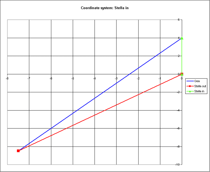

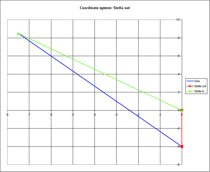

At the time Stella fires her thrusters (t=4 y in Stella's coordinates), Gea is 2.4 ly away, and 1.92 y older.
Directly after firing her thrusters, in her new coordinate system, Stella will calculate Gea to be 2,4 ly away and 8.08 y older.
All that happens to Gea in her proper time interval [1.92 y, 8.08 y] is neither covered in Stella's first coordinate system until t=4 nor her second coordinate system starting from t=4.
Have a look at the attached spacetime diagrams. There are many coordinate systems you can use. You can use "Stella out" or "Stella in", but there's no inertial frame "Stella".

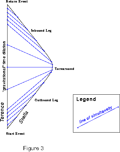

[PLAIN]http://web.comhem.se/~u87325397/Twins.PNG
Fredrik said:
I'm calling the twin on Earth "A" and the twin in the rocket "B".
Blue lines: Events that are simultaneous in the rocket's frame when it's moving away from Earth.
Red lines: Events that are simultaneous in the rocket's frame when it's moving back towards Earth.
Cyan (light blue) lines: Events that are simultaneous in Earth's frame.
Dotted lines: World lines of light rays.
Vertical line in the upper half: The world line of the position (in Earth's frame) where the rocket turns around.
Green curves in the lower half: Curves of constant -t^2+x^2. Points on the two world lines that touch the same green curve have experienced the same time since the rocket left Earth.
Green curves in the upper half: Curves of constant -(t-20)^2+(x-16)^2. Points on the two world lines that touch the same green curve have experienced the same time since the rocket turned around.
The diagram shows both twins' points of view...if we have defined a person's "point of view" as a description in terms of an inertial frame in which the person has velocity 0. It's actually not at all obvious that we should be doing that. This article uses another convention that's at least as natural.
One thing is very clear to me now from: "There is no inertial frame in which Stella is at rest in both parts of the journey." Evidently, if a frame undergoes a change in velocity (speed and/or direction), then it is not an inertial frame and SR does not apply anymore. So, I quite well understand, that in this particuilar case you need three frames:
1. Earth with Gea on it,
2. the spaceship on the outbound trip with Stella on it and
3. the spaceship on the inbound trip with Stella on it.

I think the objectionable statement by Dolby and Gull is this one: "Barbara’s hypersurfaces of simultaneity, which define ‘when events happened’ according to her, have consistently been misrepresented". That is probably overstating it, but they are certainly correct that any coordinate system which assigns multiple times to a single event is asking for trouble.
  • #32
Fredrick;
Ignore, my drawing isn't correct.
  • #33
phyti said:
When B-clock reads 12, a signal (blue) from the A-clock would show 4.
It's true that a radio signal from Earth that reaches B at the event where B's clock reads 12 must have been sent at an event where A's clock reads 4, but you seem to have misunderstood what the diagram is about, or the meaning of the word "when". :smile: From B's point of view, A has aged 7.2 years "when" B has aged 12 years. You find this result, not by following the world line of a light ray, but by following a simultaneity line. This is because the word "when" refers to a given time, and a simultaneity line is a set of events that are all assigned the same time coordinate.
The blue (and red) lines in my diagram are simultaneity lines, not light rays. And the text in the boxes isn't about what the twins see with their eyes or video cameras, but about what coordinates their co-moving inertial frames assign to these events.
