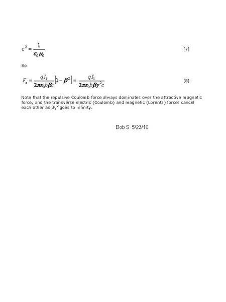

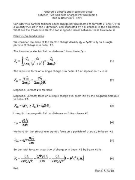

In the lab reference frame, the Coulomb force between two charged particle beams is opposite to and greater than the magnetic force, except when the beams are extremely relativistic, in which case the two forces cancel. For the Coulomb force, the electric field of one beam acts on individual charges in the other beam. For the magnetic force, the magnetic field of the current in one beam acts on individual charges in the other. See attachments. If Lorentz-transformed into a moving frame where the two beams are at rest, the force is pure Coulomb. In the case of two parallel wires, there is no Coulomb force in the lab frame.
Bob S
