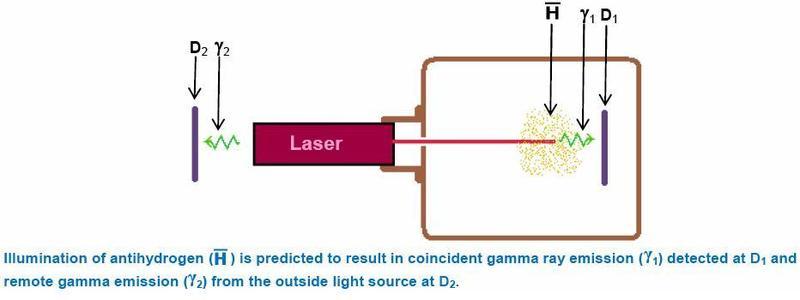

Let’s consider the photoelectric effect. You have incident light and if you increase intensity you get more electrons ejected but with identical energies. If you increase the energy (frequency) you get the same number of electrons but at higher velocities coming off the metal plate.
Don’t you agree that the same effect could be achieved with an incident electron beam? More electrons in means more get ejected but faster (more energetic) electrons in mean faster electrons ejected. Photons are like electron collisions. So maybe that is what they ultimately are. But “maybe” isn’t much in the way of proof. I agree, the burden is on me. Thus, I offer the following:
The spectroscopic character of antihydrogen is expected to be identical to that of normal hydrogen when it is ascertained soon at CERN (http://en.wikipedia.org/wiki/Antihydrogen):
“According to the CPT theorem of particle physics, antihydrogen atoms should have many of the characteristics regular hydrogen atoms have, i.e. they should have the same mass, magnetic moment, and transition frequencies (see Atomic spectroscopy) between its atomic quantum states.”
“Today, no conclusive spectral signature for the presence of antihydrogen could be reported, since measuring the spectrum of antihydrogen, especially the 1S-2S interval, is exactly the goal of these CERN collaborations.”
If that is the case, I’m wrong! About contact, zero path length, pinholes (photo-induced wormholes), remote collisions, the whole shebang! End of story. That’s because I predict unexpected instability of antihydrogen upon absorption of light from normal atoms. Specifically, there will be signature gamma emissions indicating the remote annihilations of the emitting electrons and absorbing positrons from their respective locations. All we really have to do is wait (vigilantly)!
In the meantime, I note that Mills and Cassidy who are leading investigators of Positronium (Ps, arguably the closest thing to antihydrogen currently available for investigation) report http://focus.aps.org/story/v16/st16:
"Mills and his colleagues found a higher decay rate with the denser pulses - clear evidence, they say, of frequent positronium collisions, an important step toward making molecules. They were surprised, however, that the decay rate was four times as high as expected based on the simplest understanding of the collisions." I enquired about the possibility of light contamination but received no reply.

“What do you care what other people think?”, R. Feynman, in a book title no less! Do you think he meant it?
Please excuse my sometimes, “playful” wording on a subject you obviously take seriously. I take it from your PF name, that you have an advanced degree in physics. I respect your accomplishment and value your opinion. I don’t think you should change that opinion based upon anything I’ve written. Demand proof! I believe Dr. Gabrielse and colleagues will be as pivotal to pinhole theory as Sir Arthur Eddington was to Relativity (description above, diagram attached).
Can you imagine the blunder though, if without testing, we continue in the assumption that light (from normal matter) is exactly the same as antilight (from antimatter). There could be entire distant galaxies of antimatter out there and their dim rays would be entirely invisible to us unless we adapt telescopes to detect the characteristic secondary gamma emissions resulting from remote annihilations. Here's to not keeping ourselves in the dark. Good day.
