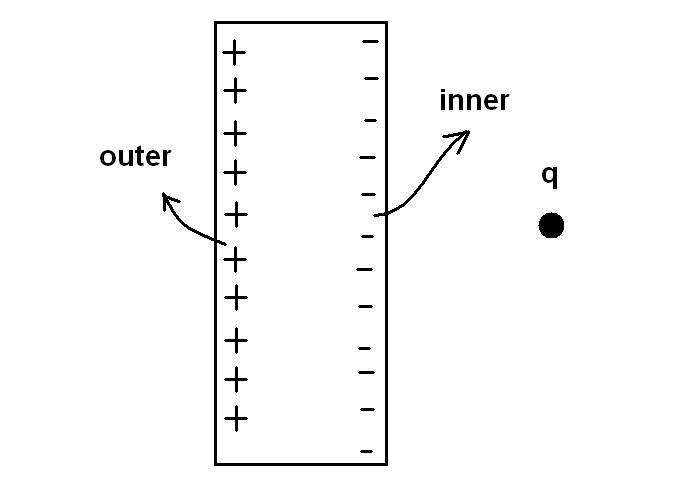

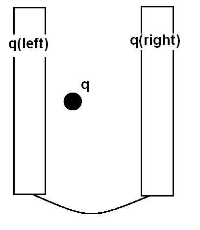

From the question statement, the situation I understand is like the attached picture. And the solution guide, I have already posted it earlier. But reading your solution, I thought you were referring to some other problem! So there is either something wrong with the problem statement or something wrong with your understanding.
@ehild: I don't see why the outer charge is evenly distributed.

Assume that you have a point charge q at one side of a very large conducting plate.It attracts the opposite charges which accumulate nearby and repels the like ones which appear at the other surface of the plate. What is the electric field in that outer half of space? The electric field is zero inside the conductor. The outer charges do not feel any force from the charges which are at the other side. They repel each other and spread apart as much as possible.
Now you have two plates at opposite sides of the point charge, and they are electrically connected so the charges can move from one to the other. What do you think about the outer surface charge densities of the plates and the field in outer space? I ask it seriously as that question made the most problem to me. ehild
If you take the hint that that q can be considered as a sheet of charge then the arrangement can be considered as two capacitors in parallel,the sheet of charge being a common plate for both capacitors.

Why do the outer charges feel no force? They are repelled by q (and also attracted by the inner charges). The electric field inside the conductor, which is zero, is the sum of electric fields due to q, the inner charges and also outer charges.
How do you define an ideal conductor? So what are the field inside a conductor due to any charge outside? And what is the relation between force and electric field intensity?

The inner charges we were talking about are also "outer charges" if we understand those as charges on the surface of the conductor. The terms "inner" and "outer" we referred to are only to discriminate the charges near q and the charges far from q.
When the system reaches electrostatic equilibrium, the charges on the conductor feel forces whose sum is zero (or maybe this is what you meant by "feel no force"). But the forces are not essentially electric forces. There is also the bond in the crystal structure.
Consider an element charge on the surface dQ>0. Let E denote the electric field due to dQ. Because the total electric field inside the conductor = 0, the electric field due to others at the position of dQ is also E, but in the opposite direction. Therefore dQ does feel electric force = EdQ. The force to balance it out is due to the bond.
The total electric field inside the conductor is zero, i.e. E(by q) + E(by inner charges) + E(outer charges) = 0. But we cannot conclude anything from that.

One charge on the outer surface of the plate just opposite to q can be much closer than an "inner" charge far away from q. So the terms "near" and "far" do not properly characterize the position of the charges.
You know that the conduction electrons are free to move inside the metal. That "bond because of the crystal structure" just does not let them to get out. That is why the excess charge on a metal accumulates at the surface.

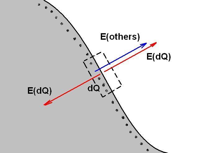

Do you mean the electric field due to a point charge dQ inside the metal? How do you get it?
ehild
I don't really understand your question :P
The electric field E is formed only by dQ. It's not the total electric field. And dQ is not inside the conductor, it's on the surface.
And what is the electric field formed only by dQ inside the metal? Show an equation.

@ehild: I'm not sure if you got my point. Maybe my writing is a bit confusing?
See the attached picture. Consider a charge element dQ on the surface of the conductor. By Gauss's law, we can prove that the electric field due to dQ only is E(dQ) = dQ/(2eodA). The red vectors correspond to the electric field of dQ. We know that inside the conductor in equilibrium state, the total electric field = 0. So the electric field due to the others charges (all excluding dQ), which is represented by the blue vector, is E(others) = E(dQ). This should also answer your question.
My point when speaking about this is that dQ experiences the electric force, because there is E(others). That means, back to the problem, there is electric field due to q and the inner charge layer at the position of the outer layer. The outer layer's charges cannot be evenly distributed because they are not in their own electric field.
I've checked in on this after a day and I'm amazed and grateful at the responses I've gotten.
First of all, I'd like to just say that if anyone has any issues with the question itself, I'm not the one who came up with it, nor the supposed value for the induced charge. I was merely stuck on that problem, and couldn't see a way out.
@ehild I think understand your misgivings about my solution. Grounding the plates makes them no longer electrically neutral. I think also that you imagine the plates to have some 'thickness' so that charge can be on the 'in-facing' surface and 'out-facing' surface, which I too considered but I could not work out how this would affect the electric field outside the system. Also, I think you refer to the charge in a hollow cavity situation, where if a charge is in a hollow cavity in a conductor, outside the conductor we can tell what the magnitude of that charge is, but not it's distribution. If you were suggesting this, I'm not sure that it applies here, because the plates may perhaps not be infinite but finitely large (unlike what I previously suggested) and so the point charge q isn't completely surrounded by conductor material.
And I am quite sure that I wouldn't be able to solve it if I considered the charge q to be point-like.
@hikaru1221 Yes that image is what I too had in mind. There was no diagram given with the question, so hopefully both you and I are correct in thinking that is the situation intended.
@dadface I think my method is probably the same as yours, although far more convoluted as I didn't consider them capacitors! I do believe that your method is probably the intended one as the question came up in a sheet referring to capacitance.
That's all I have to say at this point, and I think that the question must be inherently ill-designed. Feel free to use some technique to solve the point charge problem, but I think any more work on this will produce more heat that light.
