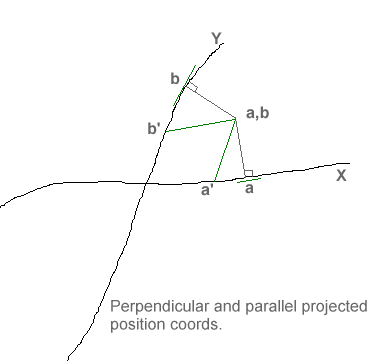

What follows may be dumbing down the subject, but it helped me when I was first learning about curved spaces and tensor calculus.
Imagine two axes, representing say, x and y directions. One usually thinks of two straight lines at right angles crossing at the origin x=0, y=0. In this case defining a position vector from the origin to a point x0, y0 is trivial i.e. drop a perpendicular from the point to each axis and read off the value. Now imagine that the axes are not at right angles, and curve smoothly. One can still drop a perpendicular to the axis and read off a value. But there's a nother set of values available - by drawing a line through the point parallel to each axis and reading off the value where this line cuts the other axis.
The two sets of values obtained thus are called the perpendicular projected components, and the parallel projected components.
The motivation for this is that the quantity defined as the inner product of these two 'vectors' is a geometric invariant. It will not change under coordinate transformations.
Writing the perpendicular vector as Xa, and the parallel as Xa, the quantity XaXa=X1X1+X2X2 = L2 is invariant.
This means that if we can write our physical observables in curved space as scalars formed by contracting tensors, they will be covariant under general coordinate transformation.
To summarize : to define an invariant length in curved space, we must allow two ways of expressing positions, the covariant and contravariant vector.
And, the metric of the space, a rank-2 tensor can be used to transform covariant -> contravariant and vice-versa, viz. Xa=gabXb

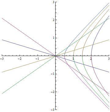

Okay. Let's see if I can envision an example. If we've got the idea we can curve space, we could turn an arc-lengths of several concentric circles into a parallel straight lines, and we could take the radial lines rom the center, and also make parallel straight lines from them.
Or, we could take hyperbolas and lines from the origin (see attached) and convert them to parallel straight lines. If we can come up with precise mathematical transformations that do these things, then we could discuss which elements are covariant, contravariant, and invariant, based on how the transformation is accomplished, right?
Yes, it's basically partial differential equations. Like Maxwell's equations written with the 4-vector potential - the vector potential is not observable, and there are many vector potentials corresponding to the same physical situation or E and B fields. So in addition to the differential equations, there is a rule saying which potentials correspond to the same physical situation. This identification of different solutions as the same is what we call geometry - the true object that remains unchanged by different descriptions of it. In practical calculations, one can gauge fix.

Sorry, I can't see the relevance of the above to what I wrote. A (crude) diagram is attached to illustrate what I'm saying. The key is that the axes are curved. Notice that if the curved axes deform back to the usual Euclidean axes, the parallel (contravariant) and perpendicular ( covariant) components of the vector coincide. So in flat space you can put tensor indexes high or low.
