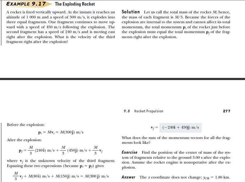

Check for me this solution in General Physic
In summary, the conservation of linear momentum only applies to objects with a total net force of zero. In cases where gravity is still present, the total net force is mg. The solution is correct and the impulse momentum theorem can be used to calculate the average external force, change in time, initial and final momentum. However, in real life situations, there may be additional factors to consider such as air drag and variation in g and atmospheric pressure.
vuvan
I reckon that we only apply conservation of linear momentum for object which has total net force acting on equal zero but in this case , the gravity force still exist , total net force is mg
Thank in advance
So i reckon the solution is wrong ? how do you think
No the solution is right.
By impulse momentum theorem: Favg.ext Δt + mu = mv
Since the time span of the explosion and by inference your observation is very short and gravity forces are comparatively weak,the change in net momentum of the system is very very small and hence momentum is conserved in a meaningful way.You can dispute that but thinking that physics in real life is full of approximations(you are ignoring air drag,variation of g and atmospheric pressure with altitude etc. already), it should seem reasonable.However the same is not true when the external force is impulsive or the time span of observation is big enough.
