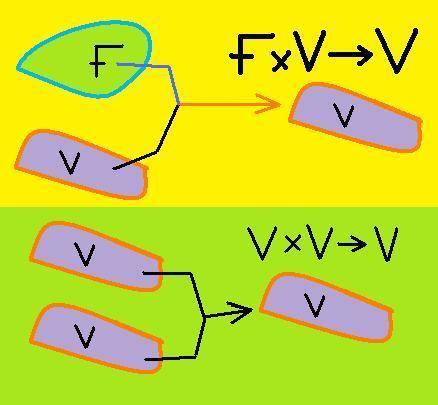

I just get the feeling that we are creating millions of sets everytime we do something in
mathematics, for instance I've seen pictures of V x V → V where there are three sets in
the picture. More explicitly V x V' → V'' where an arrow comes out of V, an arrow out of V'
and they join up and land in the V'' set, there's 3 of the same sets already so I honestly
don't know if I just think of one set or three. This is further compounded when thinking of a

5: When you write a function like (G x G, G, F), in the domain G x G are there 2 sets G?
I am thinking of a picture like the one I've uploaded as an attachment, in the V x V → V
