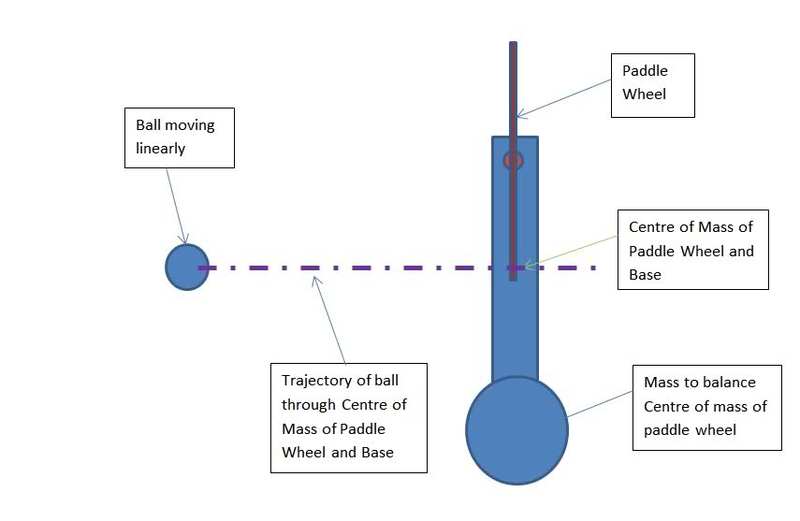

what happens when ball travels through center of mass of paddle wheel and base and hits paddle wheel tangentially . now how is going to be the conservation of angular momentum and linear momentum.

sr241, in response to your diagram: my best guess of the situation after collision is as follows. (Let the point CM be the centre of mass of the paddle-base system. The ball has initial momentum [itex]{p_{{\rm{b,i}}}}[/itex] and final momentum [itex]{p_{{\rm{b,f}}}}[/itex].)
  • The paddle wheel rotates anticlockwise about its axle with angular momentum [itex]L[/itex] w.r.t. CM.
  • The paddle-base system rotates clockwise about CM with angular momentum [itex]-L[/itex] w.r.t. CM.
  • The paddle-base system has final linear momentum [itex]{p_{{\rm{pb}}}}[/itex] (rightwards).
  • The ball has final linear momentum [itex]{p_{{\rm{b,f}}}} = {p_{{\rm{b,i}}}} - {p_{{\rm{pb}}}}[/itex].
Momentum before = momentum after = [itex]{p_{{\rm{b,i}}}}[/itex].
Angular momentum before = angular momentum after = 0 (all w.r.t. CM).
(This is ignoring any complicating factors, such as the possibility of the ball's trajectory being deflected off-axis upon collision with the paddle. I'm assuming that the ball continues rightwards along its original linear trajectory, or else bounces normally off the paddle.)
This is just an intuitive guess, so please take my answer with a pinch of salt until somebody either confirms or refutes it.

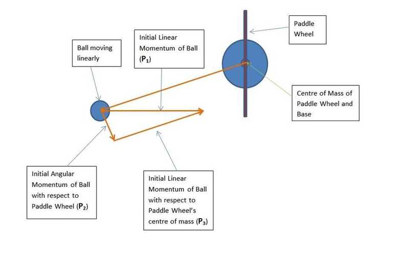

from your earlier response it seems that ball and paddle wheel possesses some angular momentum. I have made a vector drawing of it.
If ball possesses angular momentum before collision then that would be P2 and corresponding linear momentum would be P3. you mean to say P2 and P3 will separately conserved, then in a way it is the sum of P2 + P3 = P1 (actual linear momentum before collision) that is conserved. or in other words sum of angular momentum and linear momentum will be conserved. or say some part of initial linear momentumP1 will go into angular momentum
It took me a while to understand what you were doing with the vectors P1, P2, and P3. Vector P1 is the initial linear momentum of the ball. P2 and P3 are the components of P1 in the tangential and radial directions with respect to the center of mass of the paddle.
To calculate the angular momentum of the ball with respect to the original position of the paddle's center of mass, you would evaluate r X P1, where r is the position vector of the ball measured from the paddle's center of mass. This a vector cross product. The magnitude of that angular momentum will equal rP2. (Note: P2 is the tangential component of P1, not the angular momentum.)
In this collision, two things are conserved: The angular momentum and the linear momentum. The angular momentum I discussed above; the linear momentum is just P1 = P2 + P3.
