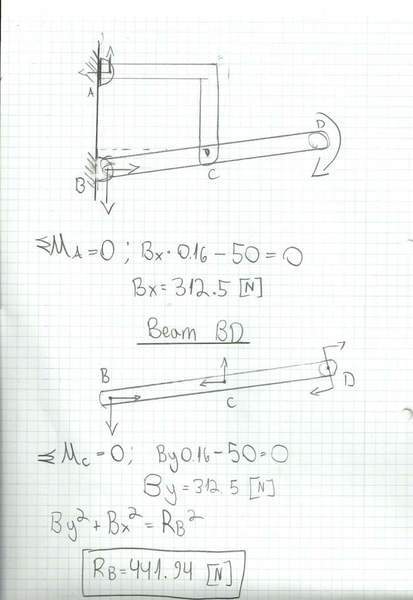

(Sorry if I'm overasking for one day. Clearly I'm doing a marathon of statics exercises today and you're all super helpful ^^)
This structure is made out of 2 weightless parts, BCD and AC, connected by joints. At C is acting a pair of forces, their moment is
m = 50 [Nm]
Calculate the support forces at A, B, and C
The measurements are in mm
Attached. The answers for Rb, Ra, and Rc are 390.60 [N]
Not sure what I'm doing wrong..?
Do you have a statics exam coming up or something?
You forgot the moment of Bx.
Not forgot, rather didn't know it exist! But, that's right --that tiny angle there counts for length! *smacks forehead* I'll redo it right now.
