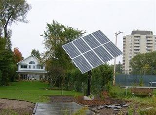

Sorry about the confusion. Let me clarify:
-A flat plane (the array) is attached to a horizontal bar along center (the fixed axis). It kind of works like a teeter totter.
-In my case this bar or fixed axis runs from north to south. It can be adjusted manually to be anywhere from 0 to 80 degrees to the horizontal.
-I have mine at about 35 degrees off of the horizontal.
-The flat plane (or array) then rotates around this tilted axis, to point the plane either East or West.
-So my question is: When the North-South bar is set to 35 degrees, and the plane is rotated around this bar by 60 degrees to the East (or West), what is the tilt of the "flat plane" with respect to the horizontal, not the bar it is attached to.
-I realize that both the plane and the bar are 35 degrees to the horizontal when it is facing due south. I also know that the plane is 90 degrees and the bar 35 degrees to the horizontal when it is facing either due East or West. What I don't know is how to determine the tilt of the plane to the horizontal for the X degrees of rotation around the bar (fixed axis).
I hope this made things more clear, and not more confusing. I will attach a picture (taken from: http://www.sunlinksolartracker.com/products.htm ) with the hope the visuals will help you understand. I can't find a good picture of the back side, but the one attached shows what the array looks like partially rotated towards the west.
Thank you so much for any help you can provide.
Kindest Regards,
Dan Rogers

Ok!
I might have figured this one out. Let me know if you think I'm on the right track.
1) I said that my x-axis runs north south, my y-axis is east-west, and z is up-down
2) I created a rotation matrix to describe the 35degree tilt of my center bar that runs north to south. The matrix looks like this:
|COS(35), 0, SIN(35)|
|0 , 1, 0 |
|-SIN(35), 0, COS(35)|
3) I created a matrix to describe the rotation around the center bar (or X axis). That matrix looks like this:
|1, 0, 0|
|0, COS(60), -SIN(60)|
|0, SIN(60), COS(60) |
4) I multiplied the two matrices to get:
|COS(35), 0 , SIN(35)|
|0.49673176494347501832, 0.5 , -0.70940647993850298834|
|-0.2867882182, SIN(60), 0.40957602215|
5) I than took the Z value of my newly rotated Z axis: 0.40957602215
and than used simple trig to say that my new tilt angle with respect to the horizontal is:
COS(Tilt Angle)= Z/1
or rearranged
Tilt Angle = ACOS(Z)
Tilt Angle =ACOS(0.40957602215)
Tilt Angle = 65.82 degrees
Does this look right?

The approach is right, but of course you will have a misalignement because of the Earth tilt.
If you want to make a good alignement you have to consider all the variable possible.
We can neglect some fancy things like the nutation of the Earth axis, of the precession of the equinox, but ok...
Your rotation matrix are about Y (the first) and about X (the second).
I don't see any rotation about the Z axis which is foundamental for your panel.

Ok a bit of an update. I have been able to calculate the tilt and azimuth; however I had to use an angle I measured using Google Sketch-up. I'm hoping someone might be able to tell me where I can get this angle from. Anyways here is what I did step by step:
x-axis: North to South through array
y-axis: East to West through array
z-axis: Ground to sky through array
Azimuth: 0 degrees = North, 90 degrees = East, 180 degrees = south, ect.
Tilt above horizontal: angle between the ground and the array (angle between inital x-y plane and final x-y plane)
1) I rotated the x-z plane around the Y axis 35 degrees (My tilt above horizontal is now 35 degrees, and azimuth is 180 degrees {or facing due south})
2) I rotated the y-z plane around the X axis 60 degrees (My tilt is now unknown as well as my azimuth)
3) I multiplied my two matrices created from the previous steps.
3) I used the position of my Z axis after these two rotations to calculate my tilt angle. This was done by calculating the ACOS of the z position of my Z axis (Cell 33 of my new matrix created in step 3). [I now know that my tilt angle is 65.8218 after rotating the single axis of my array 60 degrees east or west]-{note that the initial 35 degree rotation is a manual adjustment made to the array just once it will not change throughout the day}
*From this point forward I rotate the array again even though these rotation don't actually take place in real life. I am just using them to calculate the azimuth. Bare with me!
4) I rotate the arrays x-y plane around its Z-axis by 51 degrees (This will not change the current tilt or azimuth of the array). I did this so that my Y-axis is back in the initial x-y plane (or Earth's plane).
5) I rotated the array back 65.8218 degrees (my current tilt angle). Now the array's x-y plane is parallel to the initial x-y plane (earth plane); however, the arrays Y axis is now 71.7 degrees off of the original Y axis. This is my azimuth! Yea! Well sorry not quite... 180-71.7 = 108.3 = Azimuth
*** Now my only problem is I had to measure to get that 51 degrees in step 4. Any idea where this number comes from, and how I can calculate it. This is the missing piece in my puzzle!***

Hi Dan.
First of all you should get an angle which is different from 51°. I checked the computation more than once, but I cannot understand why this difference.
Anyway, this angle can be calculated with the concept of gradient.
To understand the gradient imagine you have your panel in a certain position. If you place a small ball on the face of the panel the ball will start to move following a certain direction, to finally fall down. This is the maximum slope you have on the panel face. This fact is because every falling object falls following the maximum slope.
The opposite of that direction is the direction of the gradient.
Now what you want is to put the face x-axis in the gradient direction, so that y-axis will be parallel to ground.
To calculate the gradient:
[tex]arctg\left ( \frac{tg\ 60}{tg\ 35 \ cos\ 60} \right ) = 78.6° [/tex]
This is the angle you should rotate the panel clockwise (looking the panel from the above).
The problem is I obtain 78.6° while you say you had to rotate it 51°.
I cannot understand, maybe you could check it again.
It's important to be understand if you rotate the panel about the ground axis or by the panel axis.
Anyway I made the computation by rotating the panel about the X axis and then about the panel y axis, but it doesn't match your data.
Maybe you could show come pictures showing how the rotating joints are displaced.
The azimuth is displaced from the south by this angle
[tex]arctg\left ( \frac{sin\ 60}{tg\ 35 } \right ) = 51.04° [/tex]
(pointing east in this example)
Again I found an angle which is different from your.
I cannot understand why. Maybe you could post some picture to show the basic movements of the panel. It would be interesting as well to see the array of panels !
See you.

.5 = COS(Gradient)*COS(Rotation)*1
I also calculated the gradient in the previous calculations from the degrees of rotation around the tilted axis. So substituting that formula for (Gradient) gives me:
R= Rotation
Axis Tilt = 35
.5 = COS(R) x COS(ATAN[SIN(R)/TAN(Axis Tilt)])
so...
ACOS(.5) = R x ATAN([SIN(R)/TAN(Axis Tilt)])
then...
TAN(ACOS(.5)) = TAN(R) x SIN(R)/TAN(35)
TAN(35) x TAN(ACOS(.5)) = TAN(R) x SIN(R) = SIN(R) x SIN(R)/COS(R)
1.212795 = SIN(R) x SIN(R)/COS(R)
This is where I'm stuck. Does anyone know hoe I can rearrange anymore to solve for R? I'm starting to think I might need calculus for this step. Any hints?
Hi Dan,
I have to revise my previous formula because I assumed the panel are moving in a wrong way.
Looking your picture cleared my doubts.
I will give you the expressions from going to Panel Tilt, Azimuth to Sun Elevation, Azimuth.
Hello, I made this piece of code which does the calculation.
It's a Visual Basic code. You can find at Microsoft a free version of Visual Basic, but all the code can be easily converted to C, or other codes.
The code is divided into two parts.
The first part is with panel horizontal, you give the tilt angle in degree and the other rotation. I called them RotationA (tilt) and B.
As you do RotationA positive, panel will face south, and RotationB positive panel will face East.
Before the second part you have the angle of the panel face wrt the ground plane and the azimunth wrt the south.
You can also fine the panel "disaplacement", that is how much you have to rotate the panel about its perpendicular to have the edge parallel to the ground (the 51 degree of the posts above).
In the second part you have the Sun azimuth and elevation. Elevation is the Sun angle wrt the horizon, azimuth wrt the south (positive toward east).
In the end you have RotationA and B which are the same angle as before.
In the examples of the previous posts RotationA=35°. RotationB= 60°
Now I have obtained the correct angles of azimuth 71, and panel "displacement" of 51.
I have quickly tested the code, if there's something wrong, just tell me to fix it.
Have fun.

Hey!
Well I can't thank you enough for all of your help Quinzio. I am currently downloading visual basic (well XP SP3 first). I can't wait to try out the code!
This was a very good learning experience. I will let you know when I actually finish my excel sheet model and will post it if you are interested.
Thanks again!
Quinzio. I have downloaded a copy of Visual Basic Express 2010. I open a new Windows Fourms application and copy and paste your code but I can't seem to get it to work. Any ideas what I might be doing wrong?
Thanks again for all your help!
Hi there !
I wrote that code for a "Console Application", which is the equivalent of the old DOS non-graphic applications. That means you have no windows-like input output, and you step-by-step into the code to watch it working.
So I now fit that code inside a Windows Form application, which is indeed more pleasant to see and use.
There is the project attached, unzip it and click on the .sln file.
It should open automatically.
With the project loaded press F5 to run it, or the "play-like" green arrow.
How to use it should be quite straightforward, that's what I hope...
To make step by step execution into the code, press F8, then launch a conversion, or place a so called breakpoint in the code.
I made it with Visual Basic 2008 version, but this shouldn't affect anything, it's a rather simple piece of code.
Have fun, bye.
