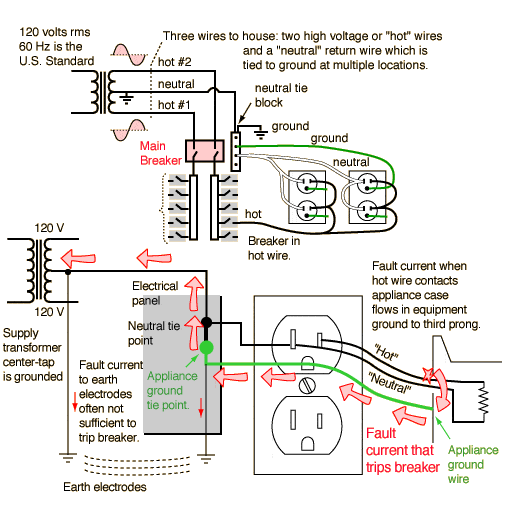

This should clear up your misunderstanding of why there's a Safety Ground, which is the fault currents path as opposed to your body.

RedX said:
It just didn't make sense to me how grounding makes one point in the circuit safe to touch, but with a circuit breaker that's true.
If you ground a point in a circuit (0 volt reference) and you touch this point (Vfinger=0) while your feet are grounded (Vfeet=0) there will be no current through your body resistance (Rbody measured in Ωs) since there's no potential difference between your finger and feet. i.e. I=(Vfinger-Vfeet)/Rbody=(0-0)/Rbody= 0 amps

That's differeent from your house where the system is earthed through a solid wire connection. At home a failed insulation passes high current which trips the circuit breaker rendering the faulted machine or wire safely de-energized.

In house wiring the first fault trips a breaker to announce its presence, and put the appliance or whatever in a safe state.
In heavy industrial wiring the power system is usually arranged so there's symmetric voltage to Earth and the first fault upsets that symmetry but doesn't pass very much current. The asymmetry is detected and sounds an alarm so you know you need to fix something. In many systems that doesn't trip the breaker.
Reason it doesn't trip a breaker is the faulted circuit might feed something very important and that gives you time to start a backup machine.
The big power lines you see outdoors are a solidly earthed system. In S Florida the neutral wire runs along the top to act as a lightning rod and is earthed frequently for that reason.
