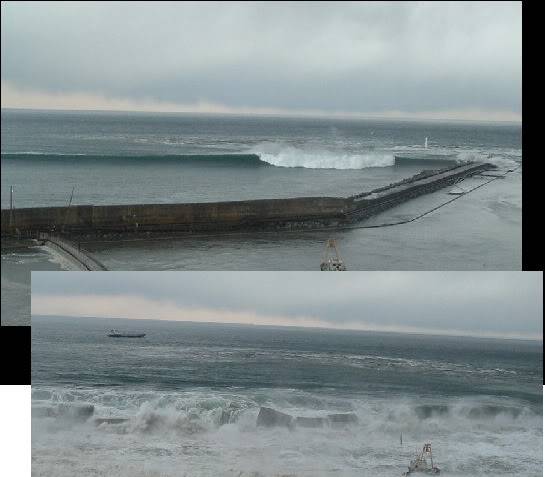

Yes, here it was :(
http://s1185.photobucket.com/albums/z360/fukuwest/Fukushima%20Daiichi%20-%20Before%20and%20during%20Tsunami/"
http://www.tepco.co.jp/en/news/110311/"

Sea walls wouldn't have helped against that monster tsunami. It's sligthly offtopic, but here's a video of the tsunami toppling a 10m sea wall:
It's only a matter of seconds until it's over the wall... and that's only the first, small wave. The big one hits a couple of minutes later.
For a monster tsunami to stop, you'd need a monster wall (http://4.bp.blogspot.com/-wgQpud-Xyg0/Tc2Xi5_s9pI/AAAAAAAAEy8/dNkOuKozE4w/s1600/FLUTTOR.jpg" one did indeed stop the Tsunami while neighboring villages were wiped out) - or you don't build sensitive equipment at water level...

Joe Neubarth said:
For a nearly blind old man like me, can somebody post a photo of them?
There was no wall, just breakwaters. (didn't read the rest of the thread yet)
