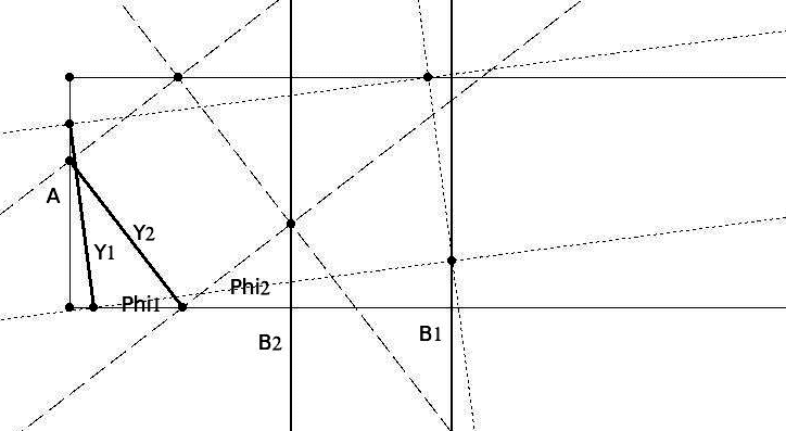

again here is the picture used throughout the discusion

robertg said:
If given the outside rectangle size [X*Y], and only one dimension of the inscribed rectangle [W], how do I get the angle (first) and length of the inner rectangle (which would come easily after finding the angle)?
I get a quartic in terms of X/W, Y/W for the tan of the angle. What do you get?
I used a similar one, but unfortunately, we have both used X and Y with a different meaning, and numbered differently segments that make up the sides. Correspondences are:
your X → my A
Y → B
x1 → a1
x2 → a2
y2 → b1
y1 → b2
w → X
h → Y
theta → 90°-phi

I say that geometrically meaningful solution can be at most three because I proven it: proof is on last page of the text I attached to my first post:
https://www.physicsforums.com/attachment.php?attachmentid=36642
However, the proof can be grasped intuitively, at least in case Y ≤ A ( or Y ≤ B, interchanging outer sides) looking at the following picture:
Given a (semi)infinite rectangle of base A, we can insert in it the given side Y so that its endpoins fall on A and one of the two half-lines (no matter which, for symmetry). For example, at positions Y1 and Y2. To each position corresponds a different angle phi between A and Y, that varies obviously between 0° an 90°, and, if phi is not 0, drawing obvious orthogonal lines (dashed in the picture), we can build the only inner and outer rectangles that could be inscribed, the former in the latter, with the given phi. The value needed for B is the distance from A of the farthest inner vertex (in the example, B1 and B2).
Of course, for phi→0, B(phi) tends to infinity, B(90°) = Y, and for phi→90 B tends to Y+ (from right:. i.e., B(90°-dphi) - B(90°) > 0).
This is enough to state that, in its graph, every horizontal line B=constant (= Brequested) intersects it in an even number of points (counting their multiplicity). This number cannot be 5, otherwise we would have a quartic with 5 solutions or more.
