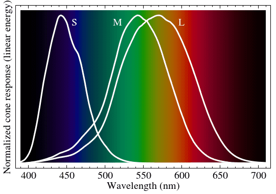

Our eyes have 3 types of cones to perceive color, one for red, one for green, and one for blue.
On the one end of the spectrum we see red.
But on the other end of the spectrum we do not see blue, but beyond blue we have violet.
How is this possible? :confused:

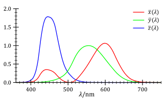

A bit of research found these images and their related wiki articles.
http://en.wikipedia.org/wiki/Color_vision
http://en.wikipedia.org/wiki/CIE_1931_color_space
They appear to contradict each other!
What is going on? :confused:

I don't understand what the problem is with that. 'Violet' is simply the name we ascribe to the color we see beyond (higher frequency than) blue. While the central sensitivity of the blue-cone is a little lower in frequency, we are still able to see a little higher.
If you read the articles, you'd see that those two plots are describing quite different things. First: they both particular models (one of them is from the 30's---from a particular study).
Second: One describes the overall human response in a particular study, while the other is the cone's response in particular (not to mention this is a normalized plot).
Ermm, but the 30's CIE model at least explains violet beyond blue in a sense, while the cone-response-curves does not?!

That's because the three receptors are poorly named "red" "blue" and "green". As you can see from the plots, each receptor actually can detect on a large range of frequencies. But any frequency location (looking at a vertical slice on your plot) has a unique combination of inputs from the three types of receptors, which can (theoretically) be decoded by a downstream neuron as a particular color state.

I like Serena said:
Are you saying that the blue-cone is actually a violet-cone?
No. The peak of the sensitivity centroid is at blue, there is still some sensitivity at higher frequencies--at violet.
Yes of course, the peak is at blue. :)
But suppose only the blue cones are triggered, would that fool our brain into seeing violet?
In other words, if we would disconnect the red and green cones (if we could), would we then perceive blue light as violet?
Only the blue cones triggered isn't enough information.
We also must discuss magnitude, which varies with frequency (the "blue" cone still varies it's response across the range of frequencies it responds to, giving downstream neurons information to decode.
I think triggering blue cones gives rise to violet and red cone stimulation and bue cone stimulation is required for blue, the names of the cones do not match up with the actual colour percieved, the names arise from the originators of the theory.

The other cones still pick up light, even though it isn't the peak absorbancy. How well these cones are absorbing the light from a particular area of the visual field is how the down stream processing happens.
Different parts of your visual field (for color, movement, shape, etc) are coded and processed in by specific ensembles of neurons in your occipital lobe.
Let my try a simplified example to see if that helps.
Suppose you were looking at a purple grape in the upper left quadrant of your visual field. Those rods and cones on your retina, taking in that specific little area of light are mapped further down stream in the brain. So that specific retinal ganglion cell (and the rods and cones its processing for) gets activated.
All the cones get activated, whether they be blue, red or green. The "blue" cones however absorb the light best, while the red and green absorb it not as well. This "comparison" between absorbancy is the information "sent on" by that part of the receptive field.
Color processing starts there at the retina and gets more refined as it is "passed back" along the visual tract (optic nerve, chiasma, radiations, lateral geniculate nucleus and eventually visual cortex). The visual cortex has different layers and complex processing happens in a couple of them IIRC.
In the primary visual cortex, some ensembles of neurons respond better to information derived from ganglion cells from from specific wavelengths of light, better than others. This differential excitation of neurons in the visual cortex gets further passed along and further processed. I don't think anyone has worked out the exact details as of yet.
Eventually this information gets passed on to secondary and multimodal processing areas of the brain--Which integrates many kinds of sensory information (say for instance, the color of flame, the shape of flames, the sound and smell of something burning, etc). Which allows you to have your conscious perception of what your senses are taking in (though the brain does a great deal of filters your senses without your consent).

The eye’s red receptor has a secondary absorbtion/response at short wavelengths in the farther indigo overlapping the blue receptor. The brain interprets naturally this as the mix of red and blue i.e. violet in this case, and so it looks like purple to the brain.
This is not easy to find on the web.
Most pages about color are mistaken in this regard (as are essentially all school teachers and people that believe that the color circle is a physical reality – it is a brain reality!). I use the “question”? “Why does violet look like purple” in my university course on “innovation and creativity” as an example of the “unasked question” that leads to scientific progress when it is finally asked.
