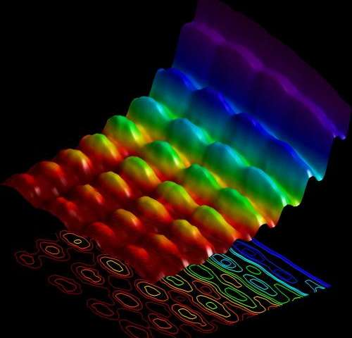

MARCH 2, 2015
The first ever photograph of light as both a particle and wave
by Ecole Polytechnique Federale de Lausanne
https://phys.org/news/2015-03-particle.html
Merel said:
MARCH 2, 2015
That is both a cool visual and an ingenious and subtle experiment... but when you read the details of how the experiment worked and what that photo is showing, you will come to two conclusions:
1) phys.org headlines are not trustworthy.
2) it’s not helping any with this FAQ
If we’re going to discuss this experiment it’s probably best to start a new thread (or look for one of the threads we already have about it) instead of grafting new discussion onto this one.
