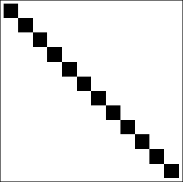

hello ,
I need to solve a differential system with mathematica that has the form :
B'=A*B
knowing that B and A are (12,12) Matrix and with initial conditions B(0)=I
Can you help me please
Thanks
Try something like
Code:
n = 12;
B[t_] = Array[Subscript[b, ##][t] &, {n, n}];
Bt = Array[Subscript[b, ##] &, {n, n}];
id = IdentityMatrix[n];
(*A=2.id-RotateRight[id,1]-RotateRight[id,-1];*)
A = SparseArray[{Band[{1, 1}] -> 2., Band[{1, 2}] -> -1, Band[{2, 1}] -> -1}, {n, n}];
The key command for getting a matrix equation into something that DSolve and friends like is the command LogicalExpand. (You can also use combinations of Flatten and Thread, but that's not as neat).
Code:
soln = DSolve[LogicalExpand[B'[t] == A.B[t] && B[0] == id], Flatten@Bt, t];
Where we could have used B[t] instead of Bt, but then the resultant replacement rules (soln) would be less useful. For the purely numerical example above, NDSolve would be quicker to get a solution for any particular range of t.
We can then plot the result using ArrayPlot:
Code:
Animate[ArrayPlot[Evaluate[B[t] /. soln[[1]]]], {t, 0, 5 n}]
Thank you very much for your help...but the problem is that since I'm not used to Mathematica I don't understand so functions that you have used.
For example I supposed in this part you defined the Matrix A
But for me the Matrix A has been calcultaed before.
Can you show me please how to implemented in my programm solution that you proposed to me .

I only defined A like that since I needed some coefficient matrix. You can see what I (almost) arbitrarily chose by running MatrixForm[A].
By the way, the stuff in (* ... *) is a comment - an alternative choice of A that I should have deleted before posting.
So to make the code I posted in your program work, you just need your own A.
There are quite a few things not defined in your code, which makes it hard to tell what you want.
It kind of looks like you're constructing the block matrix
{{premier, second}, {ID, Nul}}
but then your iterators should go up to 6...
Anyway, I'll assume that's what you're doing.
If it's not, can you describe in words how you construct A and what the result should be?

Which is much more easily created using ArrayFlatten:
Code:
ArrayFlatten[{{premier, second}, {ID, Nul}}]
ArrayFlatten would also be faster since the internal code would be optimized.
