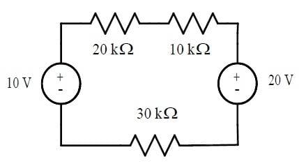

Parallel voltage sources circuit
In summary: But without an actual earth, you are free to choose any point to be the zero point. You can choose A and you can choose B (but only 1 of the two! :wink:). I still don't understand. :(
Your equations look fine, although you've provided more equations than are strictly necessary to solve the circuit.
EDIT: Actually, check the sign of the I1 term in your second equation. In your first equation you assumed that I1 was flowing from A to B, so you must maintain that convention throughout. \EDIT
What exactly are you trying to solve for in this circuit, and are you expected to use any particular method of solution?
I see, so the second equation really should be:
Sigma = 0; 20 - I2x2 - 14 +I1x4 = 0
Yes?
Yes.
Good! :smile:

What I did is calculate the voltage drop from each voltage loop UNTIL point A, then I added all the remiain voltages together (since I've discounted all the voltage drops).
So when calclating voltage difference I have to set a zero point otherwise I can't solve the thing? And just what exactly is "earth"? Is it A? Is it B?

:rolleyes: Noooo! You don't set a zero point at all. You don't need it to calculate a voltage difference.
(You only need it to calculate the voltage at a point, and you don't need that.)
Could you perhaps look at the resistor between A and B, look up the current "through" it, and apply Ohm's law to find the voltage "across" it? :shy:

If we look at each loop individually, the same loops that I composed my equations with to solve for the current, we can see that that there "voltage drops throughout the loops, yes?
For instance, if we take the first loop of the 36V, the voltage drop of that 5 ohm resistor will be Io x 5 = 31.58
When it reaches point A the 36 voltage LOST an amont of 31.58 voltage. Therefor, the remainder is 4.42.
Same with loop 2, until I reach point A, and same with loop 3, until I reach point A. Then I add the remaining voltages together.
Wait! Stop!
Yes, so the voltage difference "across" the 5 ohm resistor is 31.58 V.
Wait! Stop!
There! You have your voltage difference between points A and B! :smile:

Did I? Does that mean point B is my zero point, or my "ground point", if you will?
Hmm, B is still not your zero point.
But since you have a voltage "difference", it will look a bit as if B is zero I guess.
That is, you also have the voltage that A would have if B were the zero point.

Well let's see, if I set Va = 0 then the potentials difference you asked equals 20 - 5.211 x 2 = 9.578 [V]
Yes?
Yes! I mainly wanted to check that you were aware of the sign, and that you had to subtract instead of add.
And you were! :smile:
And you were!
w00t! This is kinda fun :biggrin:
So, I guess I should find the power dissipated now. But, I don't get what it really means. Do you want me to find the power? I have a formula for power, not for "power dissipation". Which, is really funny, because THAT IS EXACTLY WHY I skipped a really easy question in my electronic test and tried tackling this kind of circuit which I didn't have enough practice on, and exactly why I got 80 instead of 95 :frown:

Is "power dissipation" the power equivalent to "voltage drop"?
Yes
Great! :smile:
Yes.
  • #33
Let me see...
The voltage across the 5 ohm resistor is 31.58 V.
So the power dissipated in the 5 ohm resistor is... exactly what you wrote! :wink:
But... the 5 ohm resistor is not between A and B... :confused:
So no, you did not get it.
But the unit you deduced for the power looks very powerful indeed! :smile:

I like Serena said:
Let me see...
ILS, perhaps you should have specified the particular component (or components, or path) for which you wanted the power dissipation. Technically, ALL of the components are between nodes A and B, as there is are paths that will take you from A to B through all of them.
:biggrin:
Ah, I see the errors of my ways :smile:
I know what to do! *rubs hang together in an evil fashion*
Let me find Ptotal first. Then I shall have the answer, and all the smurfs will be mine!
((PS. Rtotal ends up being 6.33333 ohms ))
