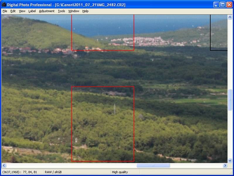

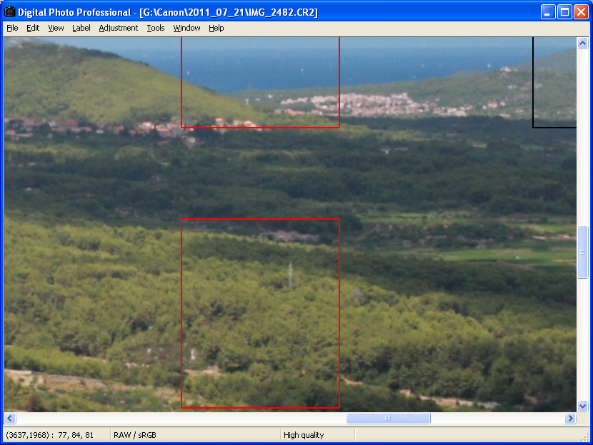

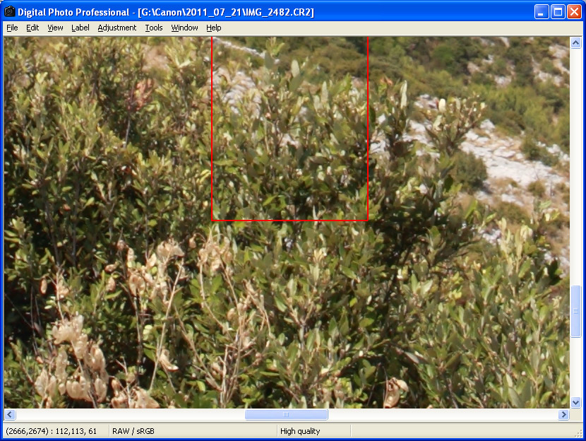

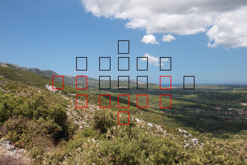

This particular picture is probably not the best example, as EXIF info about distance is rather strange (0.64? no idea what it means), but that's how the situation looks on most pictures (this is yet another lens, wider). First, general view:
And 1:1 crop:
Second plan is way too soft, while the tree trunk looks much sharper (or it doesn't? I am am stopping to believe my eyes). At 12 mm focal length and 8 Av DOF should extend behind known Universe, and not end just a few hundred meters from me, shouldn't it?
