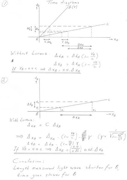

Forget this situation and consider my space-time-diagram (attached).
So my originally thought was, if two persons A and B are "looking" to the same light wave and person B with a higher speed than A (and in the direction of the light wave), person B goes slower in time because the light wave is passing him slower. I see this light wave as time (it represents time, if your speed is equal to the lightspeed, times stand still for you.
So I try to make Einstein visible to show to other people.
My diagram:
- one/same system S
- light wave starts in Xoc
- B has speed V compared with A
- when B meets A, we start our enginous clocks for measure the passing light wave length
- on any moment time ΔTb = ΔTa . (1 - Vb/C) so slower (see attachment)
Yes you are right, Ghwellsjr, thank you very much for your answer.
I know my error now I think.
I calculate the situation for B, being A (seen from A). how it would be for B probably.
And you see than already that time goes slower for B.
But I have to calculate it too for being B (seen from B) and that will be like Einstein calculates it (a refinement).
But my idea to explain it to others fits I think (compare the lightspeed with time, when you go faster the light waves are going slower passing you, so time will go slower).

Digi99, instead of using your diagrams and analyses to describe what happens when two observers count the waves of light as they go by them, consider a similar scenario on the surface of water where two observers are counting the waves of water going by them from a distant wave maker. Won't your equation apply in this situation as well? And yet I don't think you will conclude that time is going slower for an observer moving on the water, just because he counts the waves passing him at a slower rate than for the stationary observer, would you?
Attached the complete diagram, so you can see ΔTb as well.

Digi99, I'm trying to get you to see that your explanation is no different than normal Doppler which is true for water waves but not true for light waves. It does not teach time dilation. Light waves are like water waves when you view them from a single reference frame and only consider what an observer at rest in that reference frame analyzes using that reference frame and only pay attention to what that one observer sees and measures.
But if you take into account what the moving observer sees and measures, then your explanation, like water waves, does not fit. You have mistakenly interpreted Doppler to be the same as time dilation. You can easily see that this is wrong if you were to do your same thought experiment with the moving observer approaching the stationary light source. Then his count of the waves would be higher than the stationary observer and you would wrongly conclude that time was going faster for the moving observer than for the stationary observer.
You need to learn Special Relativity before you try to teach it to others. And this is the place to learn it if you are willing.

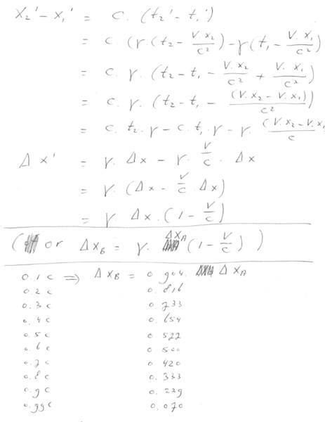

Gwh, thinking about you say here, is it not true that every object B with a higher speed as object A is always going slower in time (is that a misunderstanding from me) ? (Δt' = γ . Δt in Einstein, A and B in their own rest frames)
So this is also true for water waves except that the speed of a water wave seen from A and B is not constant as it is for lightspeed.
In my attachments I have proofed my statement.
With and without Lorenz transformations.
In timediagram 1 seen by oberserver 1 + seen by observer 1 for observer 2, in timediagram 2 seen by observer 2.
Both in/from their own rest frames.
So if an observer 2 (B) has more speed than an observer 1 (A), observer 2 sees the light wave slower passing and his/her time goes slower.
So you can explain to somebody, sees time as an passing light wave in thought, if you go faster, the light wave in thought will be slower passing you, so time will go slower. If
the light wave in thougt is passing you with maximum time, you are standing still in the universe, if the light wave stands still for you, time stands still for you. I think
that lightspeed represents our understanding of time.
In my second attachment I have something strange in a Lorenz equation, I get V = -V, anybody an explanation ?

In time_e2.jpg I had changed t1 and t2 by mistake, that was the reason.
In time_e1.jpg :
it seems that space time diagram 1 was correct, for diagram 2 I was thinking for B (in his own rest frame) to be sure but gives the same result (dividing by γ, the length contraction).
So without Lorenz is the time dilation already visible in diagram 1.
I hope that I am thinking completely wrong, than I learn at most.
Conclusion:
If you are standing still somewhere in the universe, time flies at maximum speed, if you move times flies too but slower.

I've been trying to tell you that your ideas only work for one observer. It is true that if B is traveling with respect to A, then A will determine that B is experiencing time at a lower rate than A. But the same thing is true in the opposite direction: as far as B is concerned, A is the one that is traveling (in the opposite direction) and B will determine that A is experiencing time at a lower rate than B. How does your diagram illustrate this point?

See here my first diagram (time_e.jpg, see answer #14).
You see A in his rest frame, we see a light wave and we see B moving, when A meets B, we count the total length of the passing light wave for A. A thinks by calculation for B, what the total length of the passing light wave should be for B (ΔB = ΔA .(1 - (V/C) and sees already a time dilation. But we know that has no real meaning, because it is only important how B it sees. But if I get this formula via Lorenz too for B with a γ factor, I think A has a good view on the situation, besides the formula for B is proofed and meets his total length for his passing light wave. We know already that the length contraction is 1 / γ, so we must be sure too that the results are lower otherwise B sees the same waves but only smaller.
Here you see my second diagram (time_e1.jpg, see answer #18).

Here you see how I got the formule from Lorenz (time_e4.jpg) and some results, you see the length is going lower and lower 1 / γ.
I think I have proofed now my point and now I go direction absolute points in space.
See here my next diagram (time_e3.jpg, see answer #24).
We need a light wave for both in the same direction, which direction is not important but the same direction. V1 and V2 are speeds to an absolute rest point (where our light wave has started). In the real world only V2-V1 or V1-V2 can be seen (relative speeds).
So ΔB = ΔA . (1 - (V2-V1)/C) or ΔA = ΔB . (1 - (V1-V2)/C).

You still have done what I asked for with 0.6c and 0.8c. Here's what you said in your first post:
digi99 said:
So C . T1 = V . T1 + C . T2, so T2 = T1 . (1 - V/C). It fits with the expectation of the SRT, when V=C than T2 = 0, the time stands still. When V= 0, T2 = T1.
T1 is for the "stationary" observer and T2 is for the "moving" observer. I'd like to make these into a ratio so that it will be like the reciprocal of gamma:
T2/T1 = (1 - V/C)
As you pointed out, with V=C, the ratio is 0, just like the reciprocal of gamma.
And as you further pointed out, with V=0, the ratio is 1, just like the reciprocal of gamma.
But with V=0.6C, your ratio is 0.4, unlike the reciprocal of gamma which is 0.8.
And with V=0.8C, your ratio is 0.2, unlike the reciprocal of gamma which is 0.6.
So it's quite easy to show that your scheme does not yield the correct values except at its two endpoints so although it might be "easier" to comprehend, it teaches the wrong thing.
